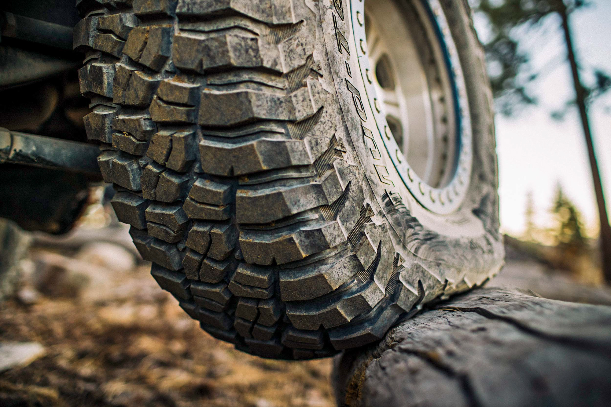

There is a long-standing rule in desert racing that if you are going to hit a rock or fixed object at speed, make sure to place it squarely on the center of the tire. The reason is that the tread block is more resilient to harsh impact than the softer sidewall. But stuff happens, and when you do clip a sidewall or pinch it in low-pressure situations, it needs to be tough. As with the KO2 All-Terrain, the KM3 utilizes CoreGard Max, a 3-ply sidewall design and rubber compound borrowed from its brethren, the Baja champion KR3. This technology has proven to be considerably more resistant to splitting and punctures—BFGoodrich states the KM3 has a 27-percent more durable sidewall than the KM2.
The first testing phase included high-speed racing in Polaris UTVs on a short course track. While it was heaps of fun and the tire did well, UTVs are not my area of expertise. I find a better evaluation to be had in a four-wheel drive and in a variety of conditions. Phase II comprised of traversing several hundred miles of hard-pack mountain roads with sections of moderate corrugations, marbley loose rocks, and steep, dry granite. With stability control disengaged, step out, or side skip, on corrugation was limited and lateral grip while drifting through fast, smooth corners was positive. I felt traction and deformation in slow technical terrain was good considering we were running 26 psi—I would normally run less. These performance attributes are a reflection of the new Krawl-TEK rubber cocktail, carcass construction, and linear flex zones in the tread block (deemed Terrain-Attack). Not withstanding cool buzzwords, the KM3 performed well in each scenario.
I would have like to put the KM3s through more mud, the bottomless soupy gumbo type, but we did find areas of moderate mud and sand. The shoulder has been redesigned, now wrapping further onto the sidewall in an aggressive directional pattern the company calls “Traction Armor Sidewall Sculpture.” Along with the addition of “mud-phobic” bars (apparently they hate mud) placed squarely in the outer voids, the tire was affective at biting the sides of trenches, clearing debris, and providing additional forward force. Sand floatation was reasonable considering the tire size (LT265/70/R17), 4,500-pound weight of the Ford Ranger test platform, and aforementioned pressure. I feel that at reduced pressure, say 10-12 psi, the KM3 will squat to form a desirable inverted-mushroom footprint and do fairly well in soft sand and snow.
