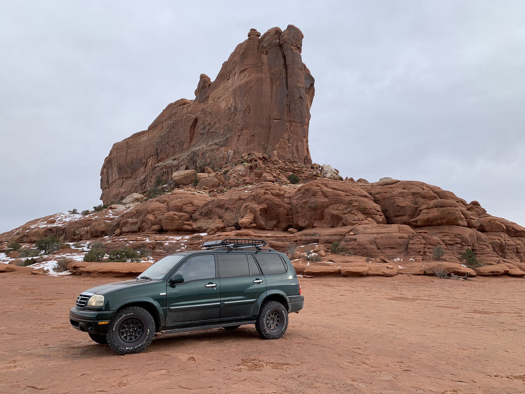

In order for those upgraded 225/75/R16 meats to fit under the Suzuki, we were going to have to lift it. We’d have to head all the way to Australia to do that, too. Not literally (we wish), but we found a lift kit that would fit from Old Man Emu, a brand with heavy off-road racing history based in Australia and purchased by ARB in 1988.
We’d get the suspension with coils and shocks for a little less than $1,000 and have it professionally installed for around $700. For our money, we’d get about an inch and a quarter of ground clearance. With the bigger tires, that would give us a two-inch bump total. That would bode well for the Suzuki as they weren’t necessarily designed for heavy off-roading. Their lowest point is the well-plated gas tank that sits at the far rear of the truck. Pick your lines carefully.
We had high hopes that the larger tires would fit under the body and with some inelegant removal of plastic wheel well material, we eliminated the rubbing. Note to other modifiers, because of the brake calipers on the front, you will need 1-inch spacers to accommodate them if you choose to get new wheels. We found this out the old-fashioned hard way when the wheels wouldn’t turn after first installing them. We grabbed four spaces from Spidertrax Off-Road for about $100, so our stance would be uniform. We like that the wheels don’t stick out bro-dozer style but give us a little more width for stability.

The KO2 tires gripped heroically, and the extra clearance from the suspension gave us just what we needed when we weren’t making driver errors and scraping our underbelly over steep steps. The Suzuki proved a worthy trail buddy as we descended to Uranium Arch and then sallied on to the monolithic Monitor and Merrimac Buttes. The only thing small about this place was our little truck. We did it.
