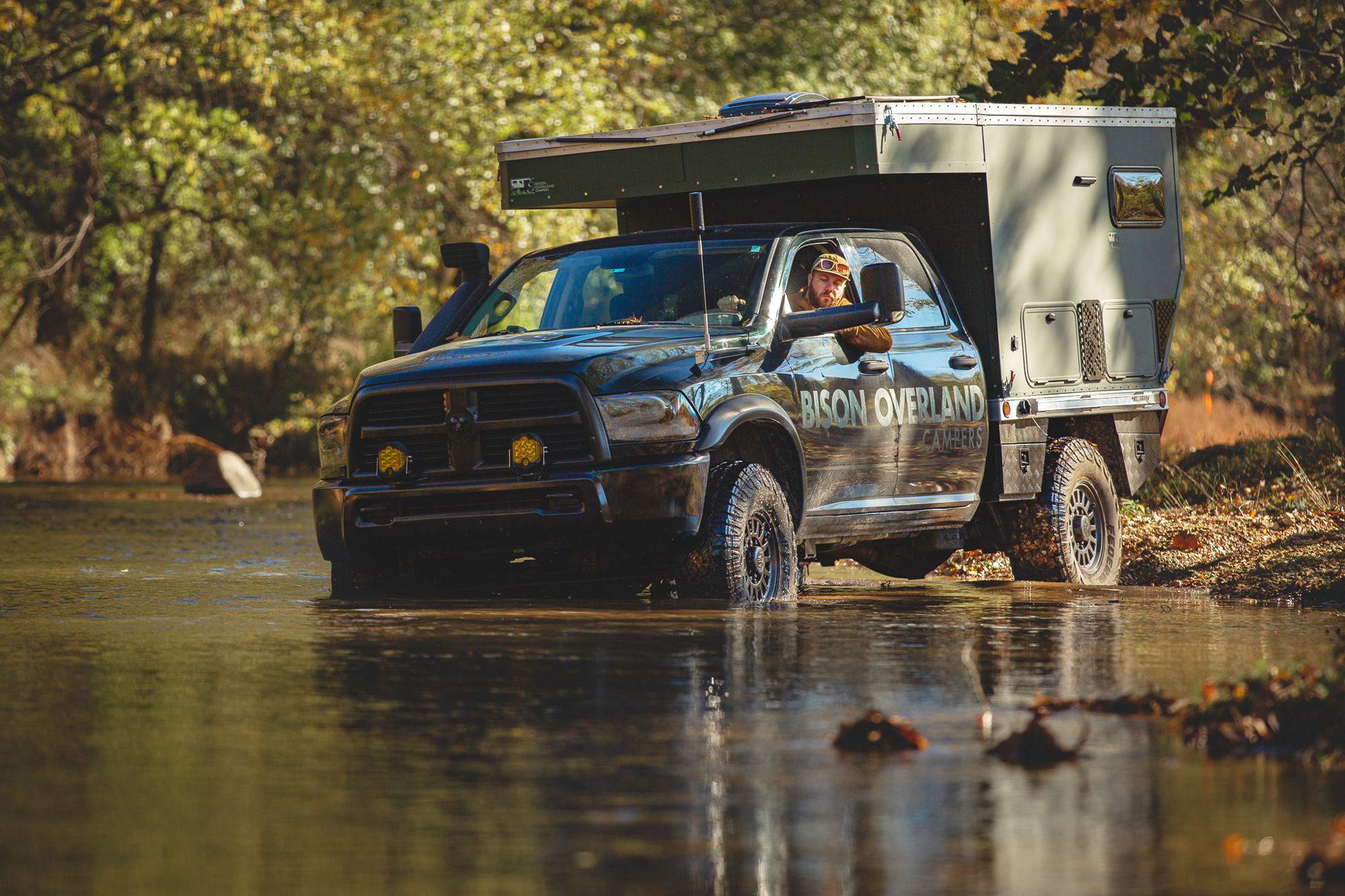

Pairing a compact camper with a 4WD truck is a capable and nimble approach to comfortable overland travel. But not every truck camper is created equal. Slide-in campers have some advantages, like simple installation, but they sacrifice space due to their integration with existing truck beds, and many are not really designed to endure serious off-road abuse. And while flatbed campers make much better use of the truck chassis in regards to space, most come with high price tags, are heavy, and can lack the durability demanded by the overlanding community. But that’s where the Bison Overland’s Space Wrangler flatbed truck camper shines.
Built by hand in Tulsa, Oklahoma, the Space Wrangler is a flatbed truck camper that’s made for extended travel and strikes an excellent balance between durability, weight, function, and price. Its designers, Drew and Cody, set out to create a more budget-friendly flatbed camper, simultaneously fulfilling their own needs while filling a gap in the flatbed truck camper market. Apparently, other travelers wanted the same thing, and since completing their first camper, Drew and Cody have seen a swell of interest.

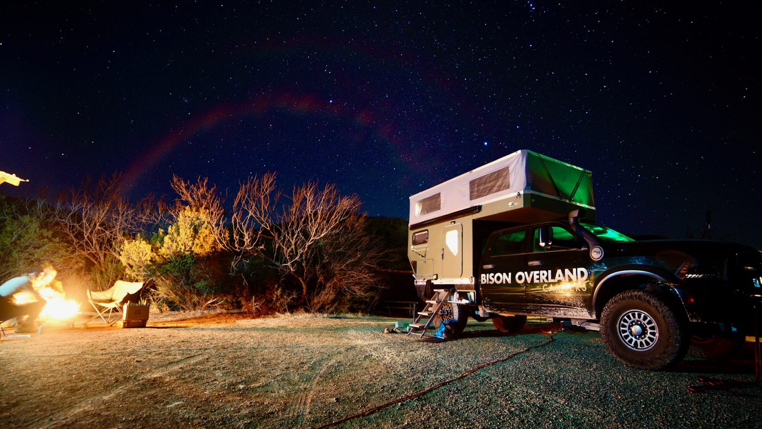

bison overland space wrangler at night
The Bison Overland Space Wrangler at a Glance
Flatbed campers aren’t a new development, but Bison Overland has managed to develop a shell that they build by hand in the US with durable materials and a budget-friendly price point, starting in the low $20,000’s. This may sound high, but it is significantly less than anything else currently available in the flatbed category (except for maybe an All Terrain Campers flatbed shell).

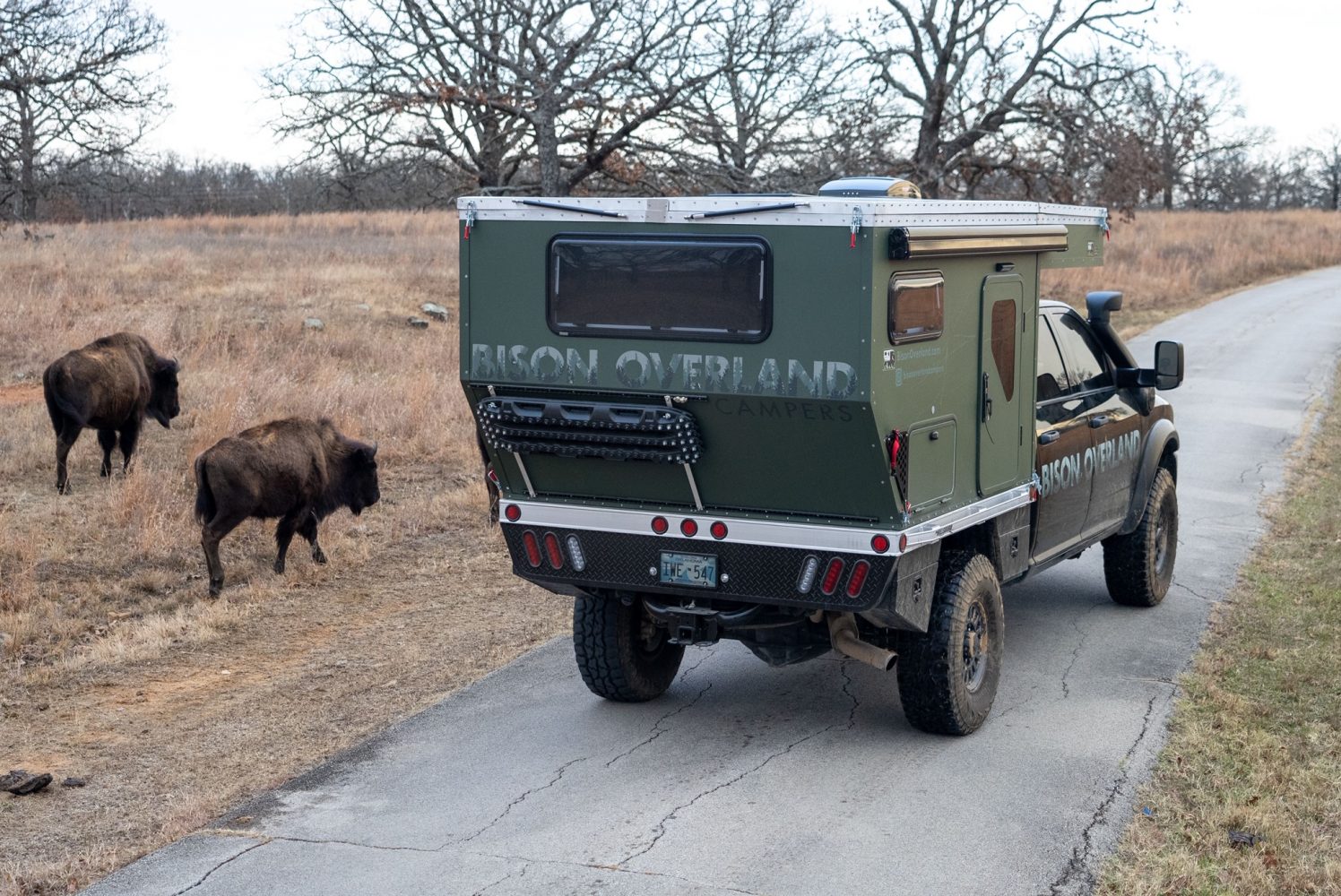

space wrangler rear
Photo: CD Davis
Space Wrangler’s Stand-out Features
The Bison Overland Space Wrangler has a handful of qualities that are worth pointing out, starting with its single-piece composite roof panel which is strong enough to support the weight of two people in the secured (not extended) position. The camper has a light yet strong, welded 1/8-inch aluminum frame and 1/16-inch-thick aluminum skin which is robust enough to shrug off contact from branches on the trail.

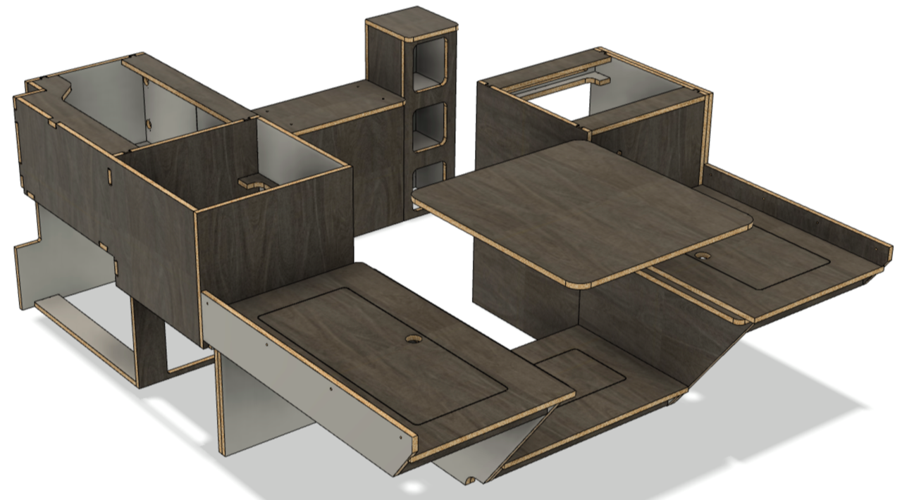

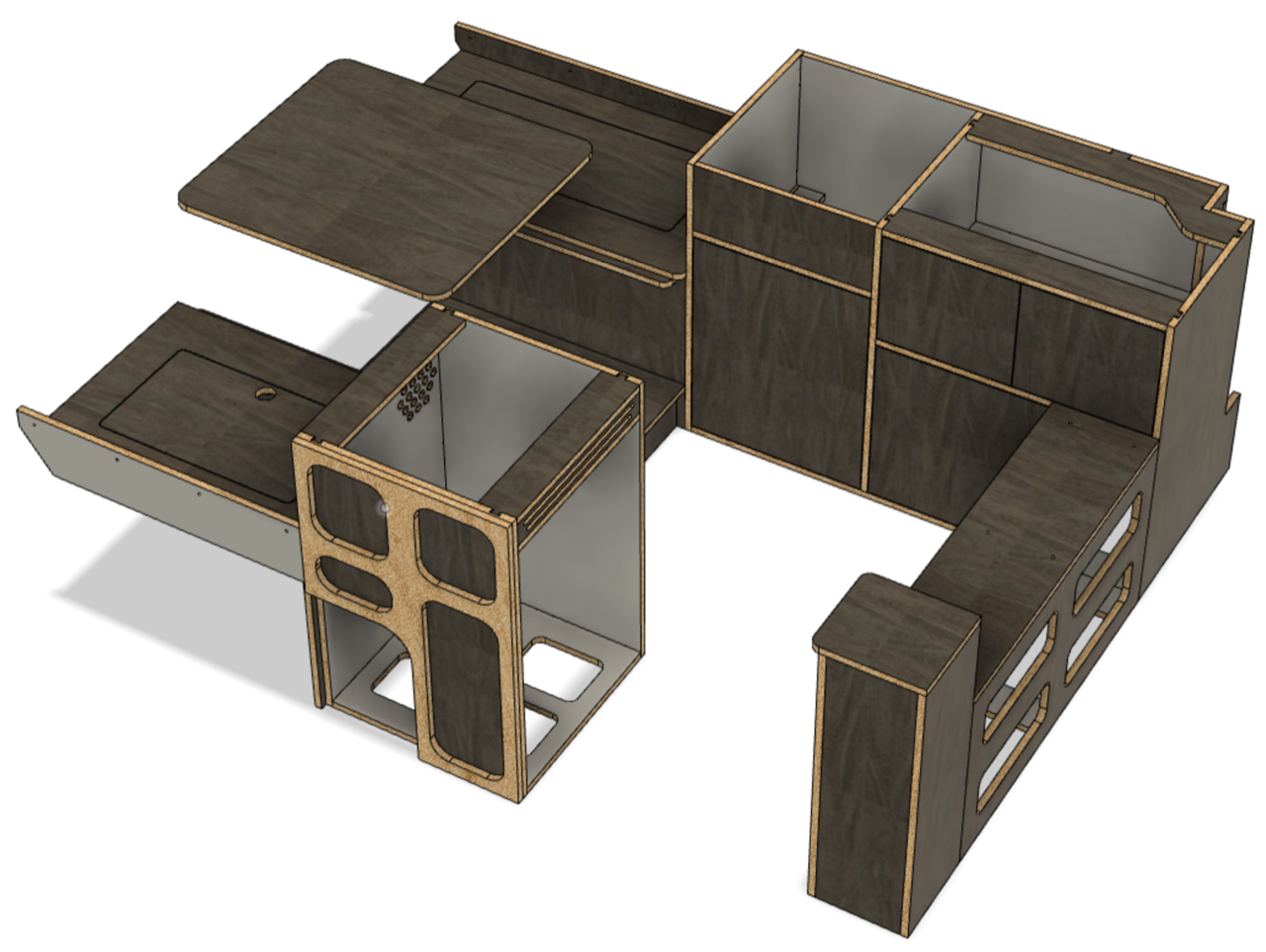

Also coming down the pipeline for Bison is a fully CNC-cut interior for the Space Wrangler shell. They anticipate pricing to start somewhere around $4,000 for this option. Of course, for those of you who are handy and want to design your own interior, the Space Wrangler shell is a solid starting point.
