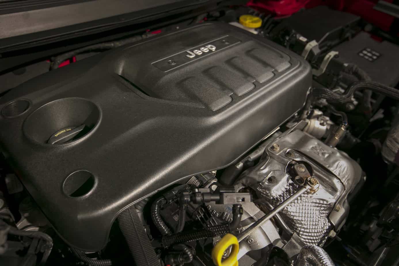

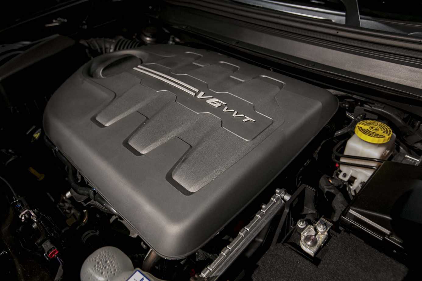

New for 2019 is a turbocharged 2.0-liter, direct-injection 4-cylinder. It is the same 270-horsepower mill found in the Wrangler, save the 48-volt eTorque regeneration system. I can tell you that this motor is not the lethargic four-banger of yesteryear, and I was impressed with the responsive nature of the turbo and smooth transition through the power band. The second option is the tried and tested 3.2-liter Pentastar V-6. With the tow package, the Pentastar raises the Cherokee’s towing capacity from 4,000 to 4,500 pounds, sufficient for hauling a small trailer or ski boat. The base engine is still the 171-horsepower, multi-port, 2.4-liter Tigershark. Although this engine doesn’t have the muscle of the 2-liter turbo or grunt of the Pentastar, it has sufficient of power for most applications, but towing capacity is limited to 2,000 pounds. All have aluminum blocks and heads, 10:1 compression ratios, and electric start/stop (ESS). I’ve had a hard time getting used to my engine shutting down at stoplights, but fortunately, ESS can be disengaged.

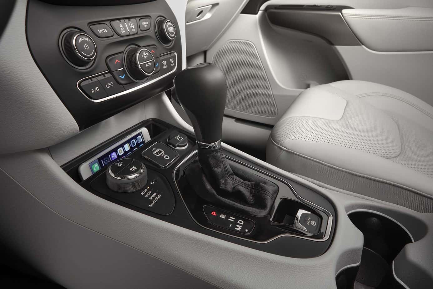

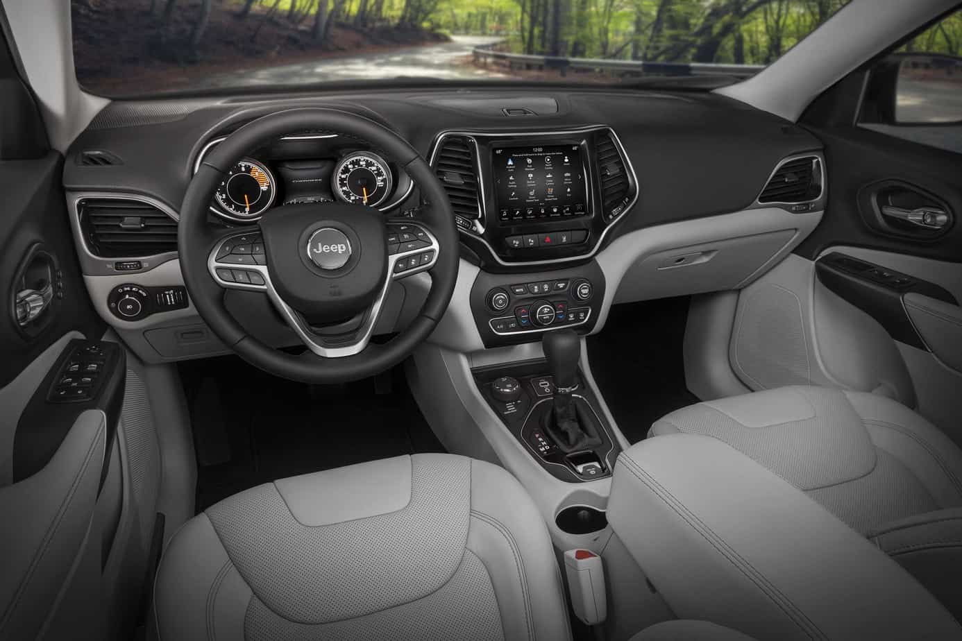

Interior trim and ergonomics have also been enhanced, and instruments are in clear view, and controls at arm’s reach. The console is now more spacious, there are additional USB and 12-volt power ports, and the Gen IV Uconnect nav/audio panel is available with an 8.4-inch touchscreen. While the Uconnect WiFi hotspot is not new, it now features 4G connectivity and Apple CarPlay and Android Auto pair with nearly any smartphone. Managing the four-wheel drive system is accomplished via a console-mounted dial. There are five modes: auto, snow, sport, sand/mud, and rock, and buttons on top activate the locker crawl mode.

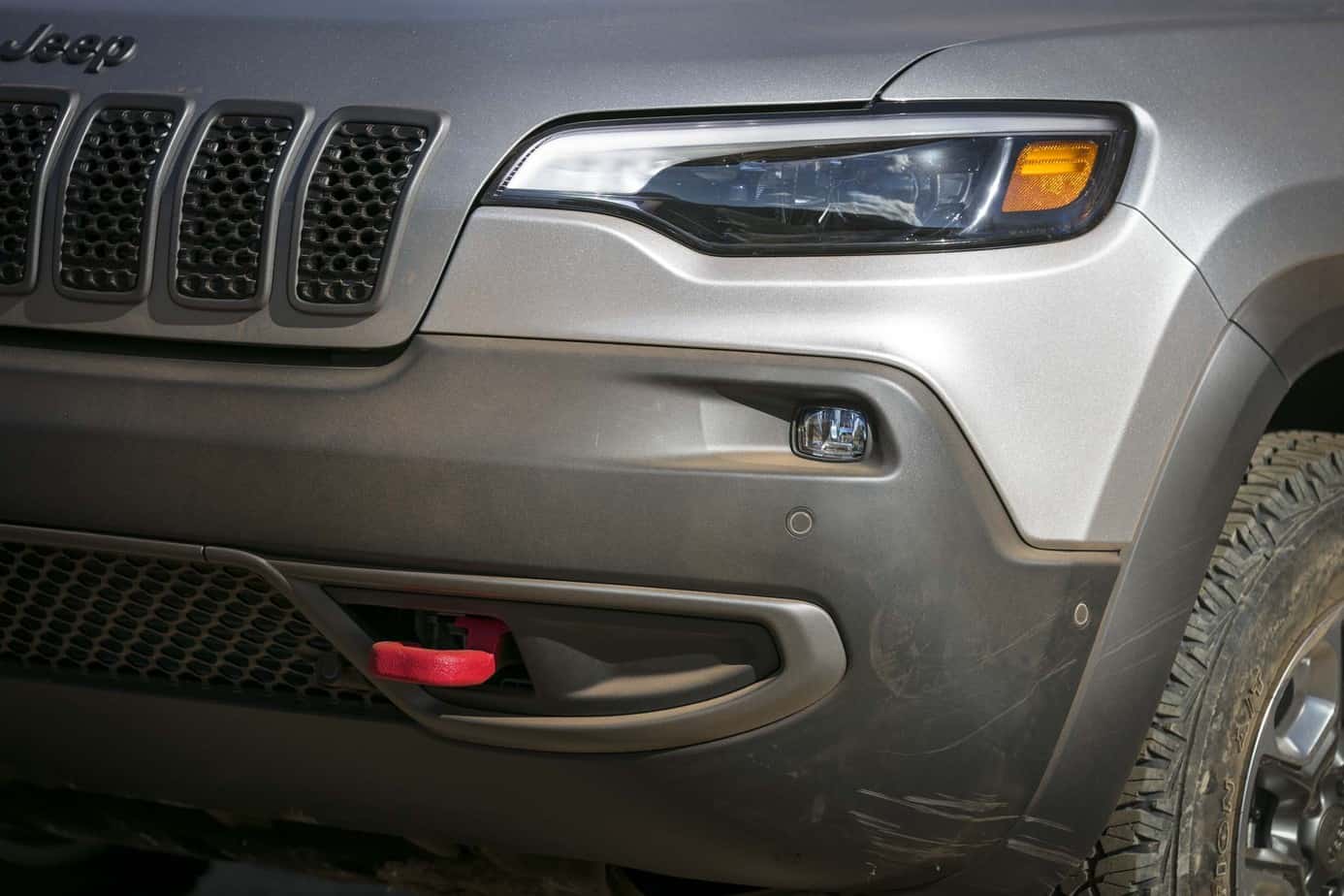

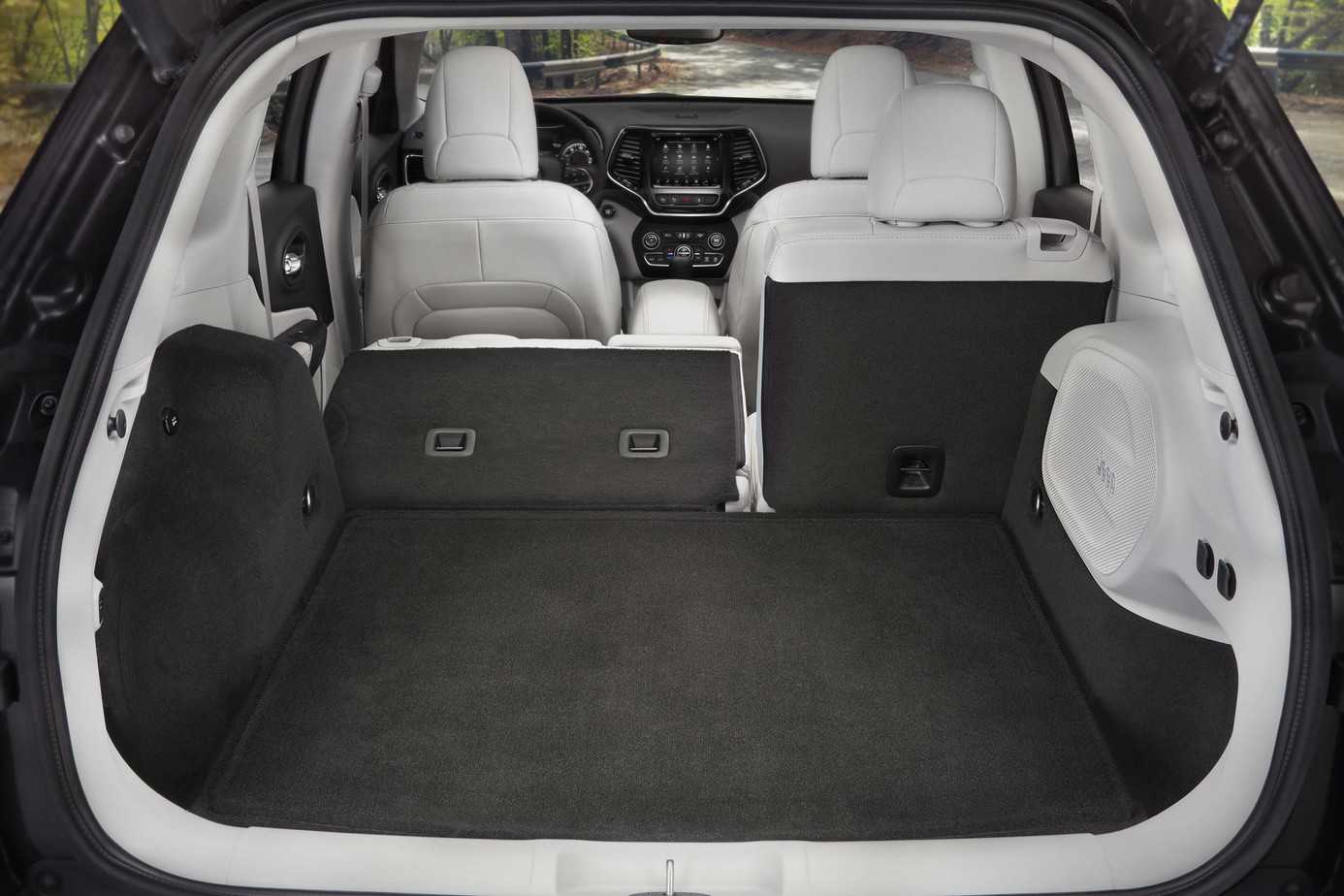

A walk-around reveals a full lineup of LED lighting (head and fog lamps, taillights, and running lights) complementing redesigned bodylines. The combination hood/grille now has a slight roll-down appearance, and the headlights sit a little higher and wrap from the fender to hood. Opening the hands-free liftgate exposes an enlarged cargo bay and 60/40 fold-down rear seats, which receive plenty of light through the dual-pane sunroof. I’m not a golfer, but Jeep boasts that you can now set your clubs in sideways.

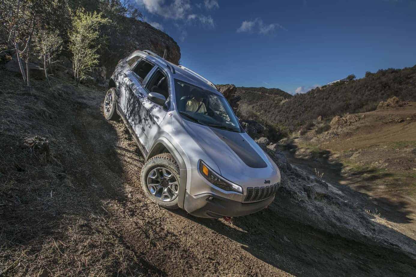

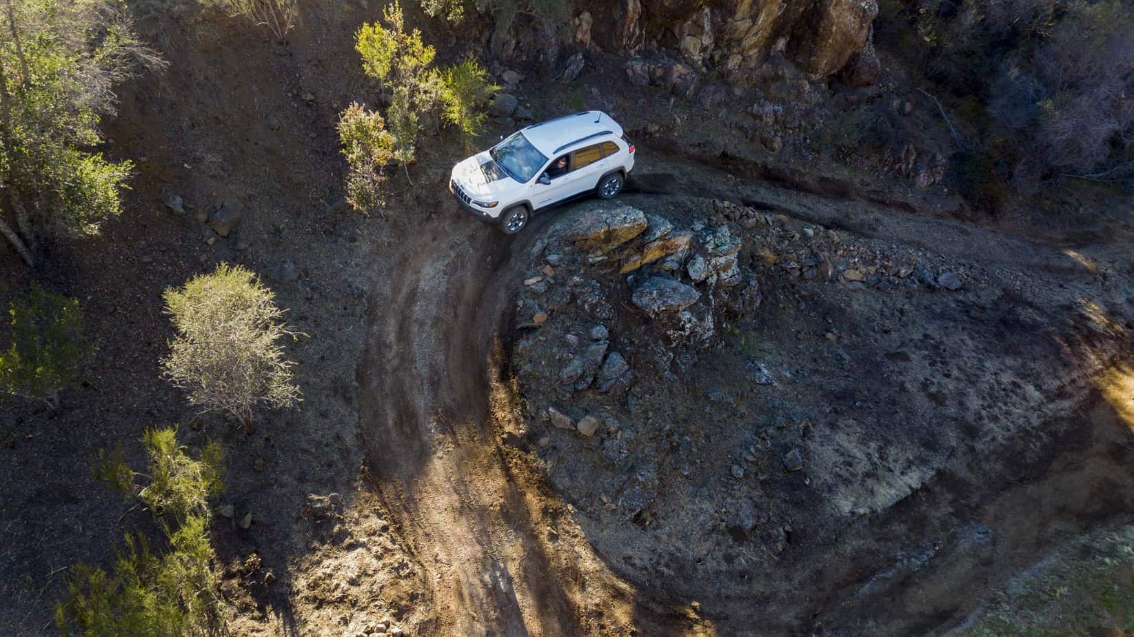

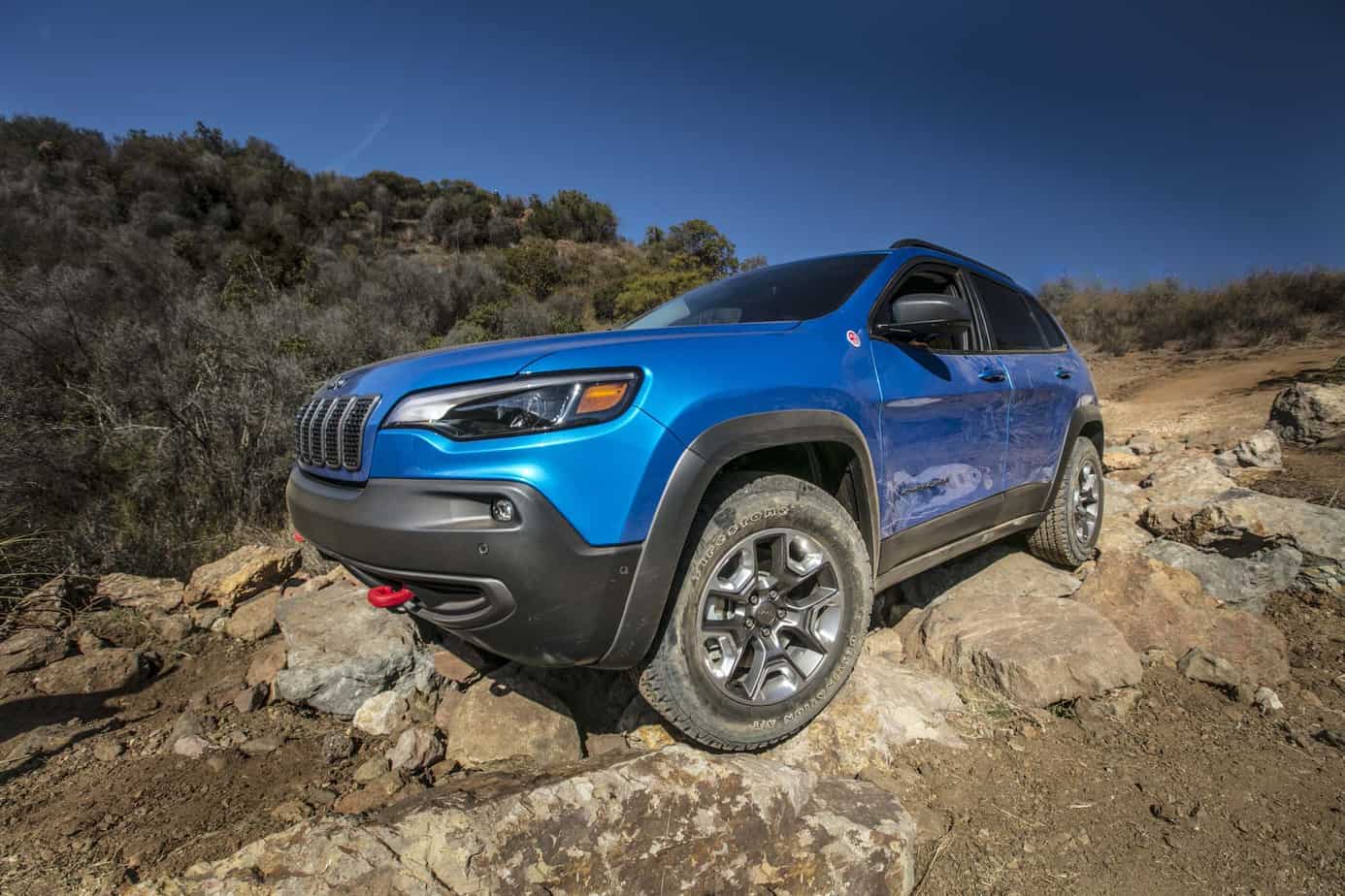

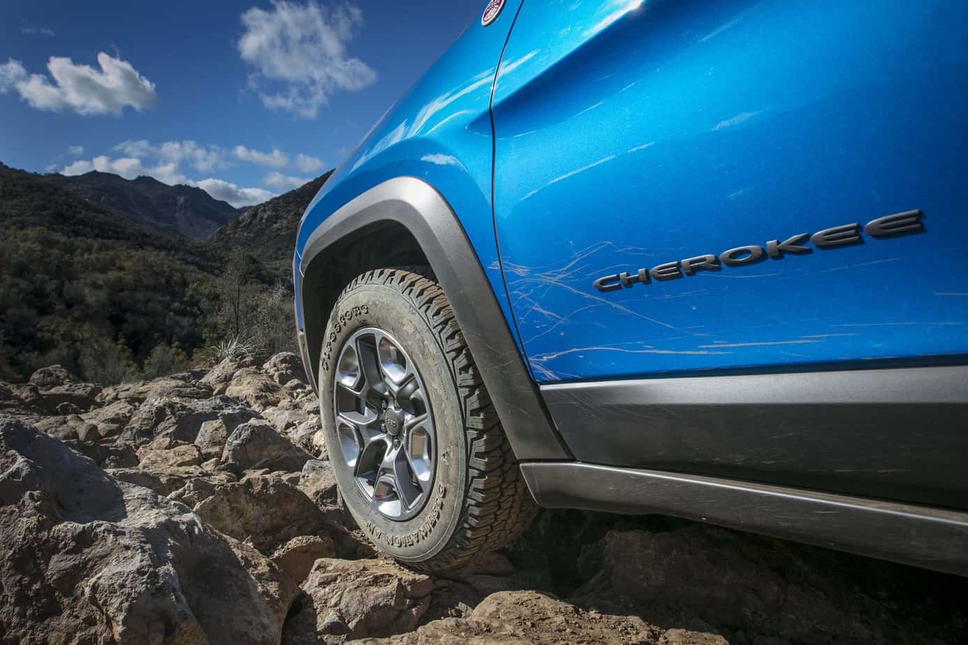

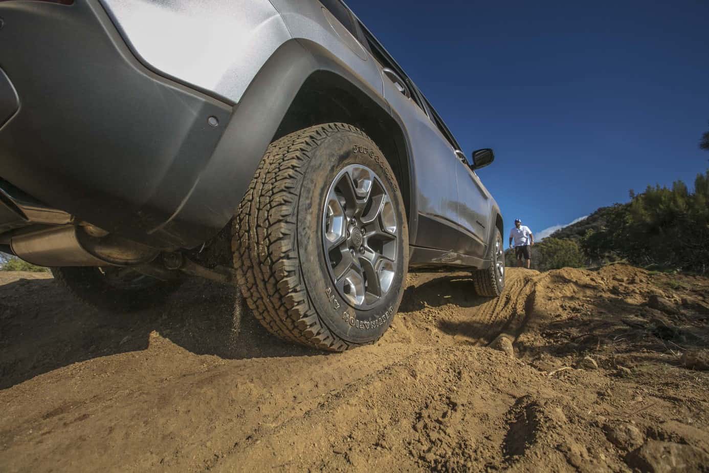

Regarding off-road prowess, while the Cherokee may not be the vehicle I would take to the Rubicon (I’d take a Wrangler by the same moniker), it is quite capable on the trail. The hill descent and crawl modes work very well, and the Selec-Terrain traction control is nearly transparent to the driver. Sections of our test course were quite technical, and the Trailhawk, which comes the electric locking rear differential as standard equipment, made short work of it. Well done!
