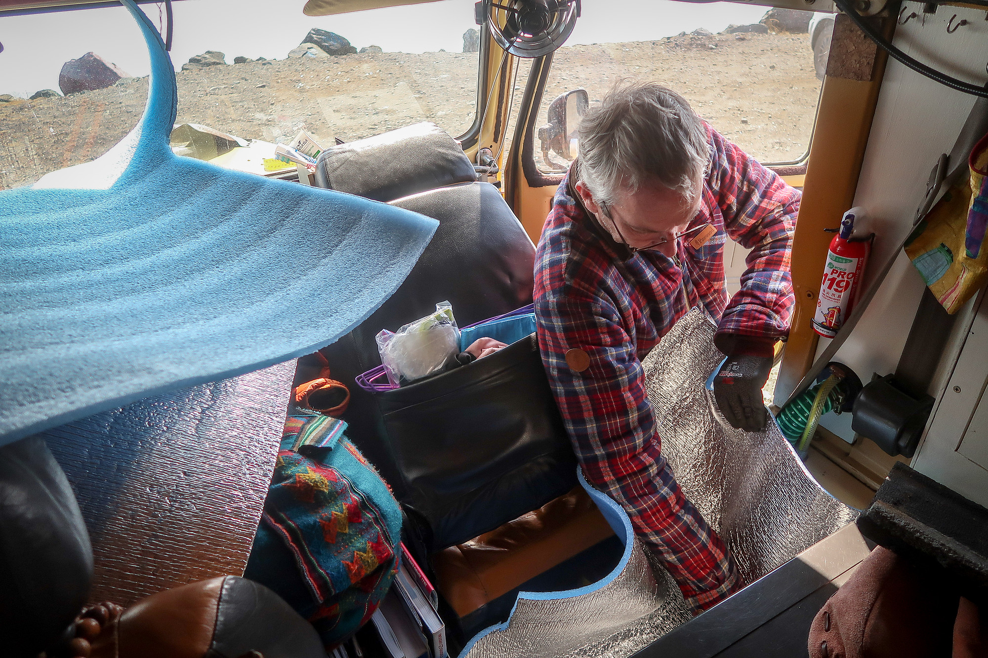

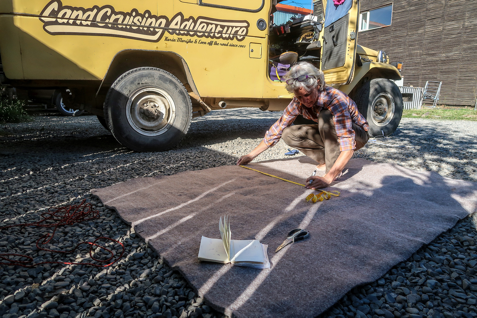

The sides and ceiling of the Land Cruiser are permanently insulated, but for the winter season, we bought additional insulation. We used large pieces to cover the floor, the lower section behind the front seats, and the rear door. Smaller pieces were fitted under the car seats and even under the floor mats. In Japan, we bought foam, while in Mongolia, we bought felt (that people use for their yurts) that worked great as well.
When parked for the night, the second the sun sets, we put foam insulation in front of the windshield and side windows. It makes a huge difference in keeping the cold out.
3. Living Compartment
Because the front part of the car isn’t insulated, it gets freezing cold there. The piece of insulation behind the passenger seats is low enough to step over when going from the front to the back, while at night we reduce the space in the living compartment by hanging blankets from the ceiling behind the passenger seats.

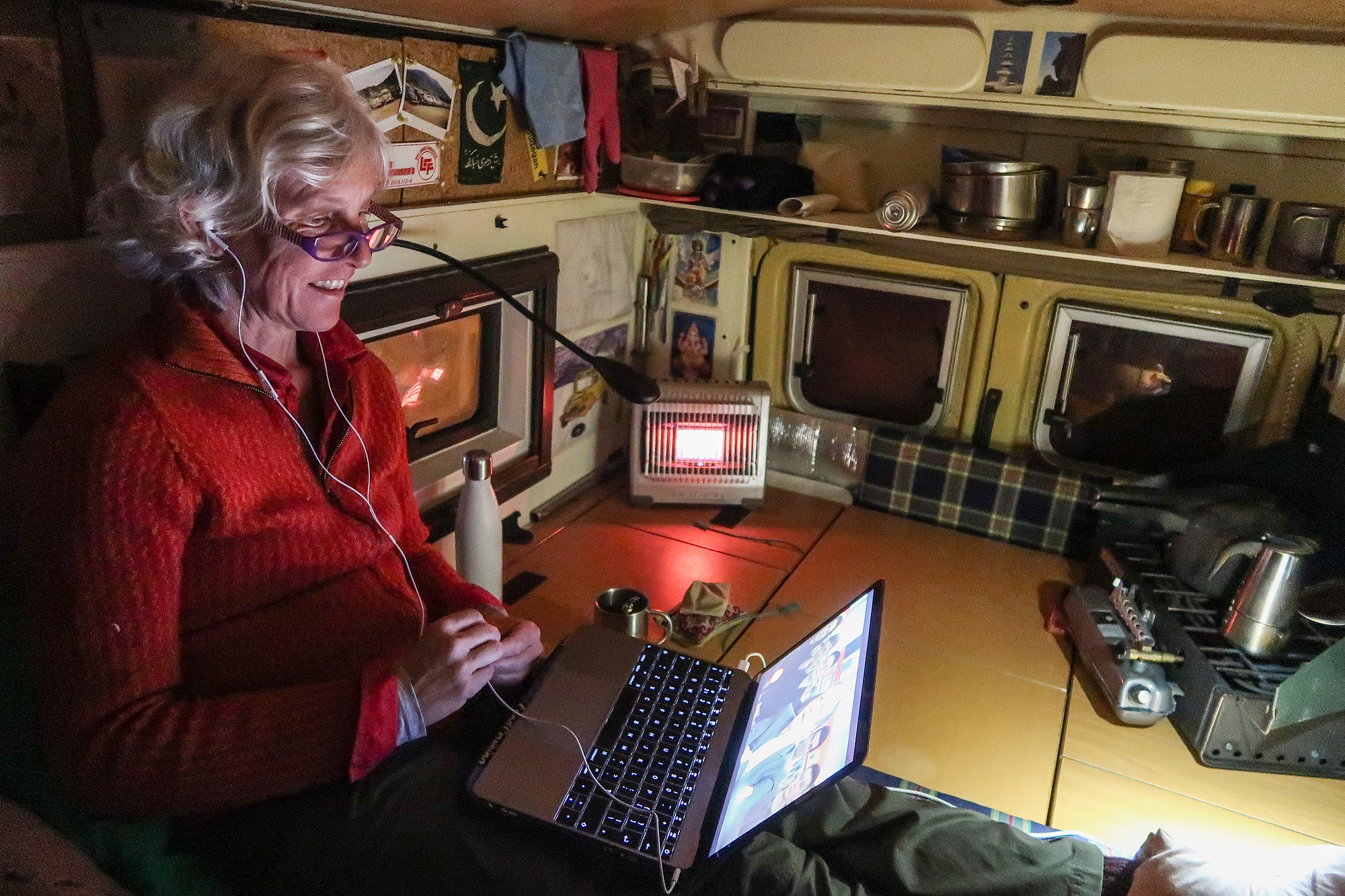

For Japan, we bought a gas heater in a hardware store that works on butane gas canisters. It gave more than enough heat for a small car like ours. If you plan on taking one long winter trip or go winter camping in the weekends, this may be a good, low-budget option.
In Russia, we started with a gas heater until Tigerexped offered to send us a Planar air heater that runs on diesel, which we gratefully accepted. Initially, I didn’t see the point in switching to a diesel heater system, but now that we have used the Planar for two months, I am very glad we do have one. There are a couple of advantages in having a diesel heater:
– There is less condensation inside the car than with the gas heater.
– You don’t have the potential problem of carbon monoxide poisoning.
– We can leave the diesel heater on while driving.
– We can schedule the Planar to start before getting up, so the car is comfortably warm when we throw off those blankets and get ready for the day, which feels like a sheer luxury.

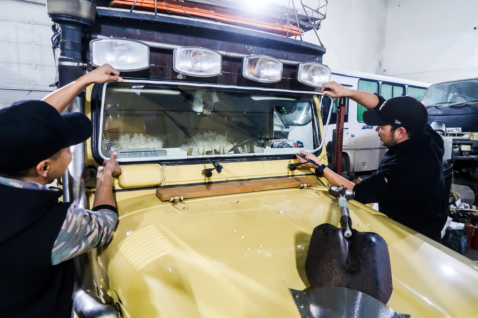

2. Double Windows
In Yakutsk, Siberia, we learned that in November locals get second windshields installed because otherwise, the driving becomes unbearable. The side windows are covered with a sheet of plastic on the inside, which we got installed as well. As the Land Cruiser has a straight window, this is simple and cheap to do. During extreme cold, such as when driving across the plains with fierce winds, these measures made a huge difference.

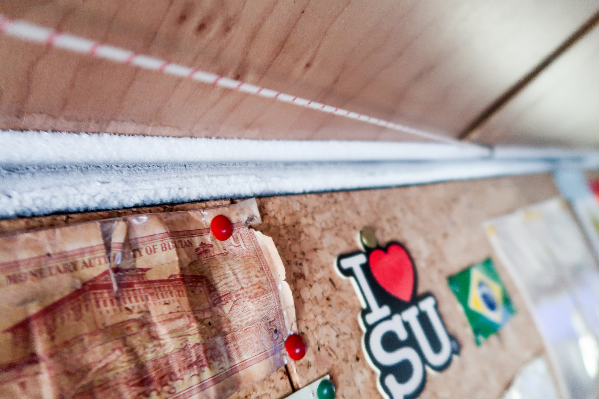

    With two of you in the back of the LC you must get a lot of condensation buildup on the inner windows. Even with a window slightly ajar. Scraping the ice can drop it onto clothing or difficult to reach locations. Ever have the doors freeze so tight you’re afraid to force them open and possibly damage the seals?
    • Karin-Marijke
      February 22nd, 2019 at 1:38 am
      Dale,
      We sprayed the seals with Teflon so no problem opening them.
      As to the window, in the rear we no longer have the original glass windows but double layered camping windows (plastic) and we don’t have to scrape them. Scraping only the front windows before driving, no problem
