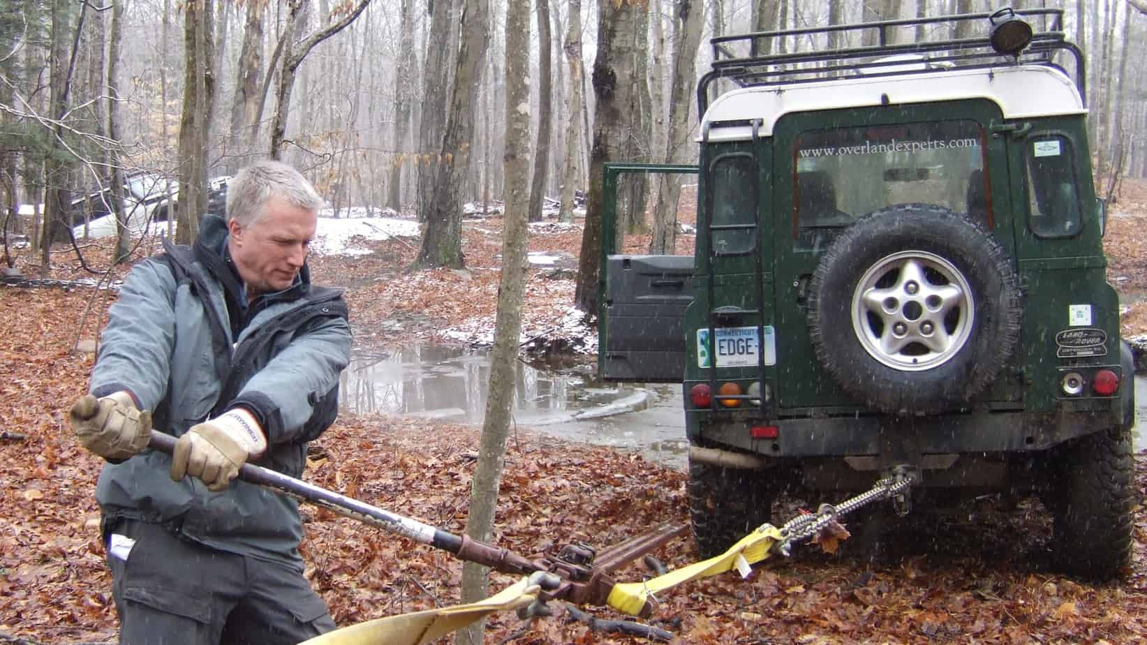

Winching
One of the Hi-Lift’s most valuable assets is its ability to be used as a hand winch or come-a-long. Many people ask, “Why not just use your vehicle winch?” One answer is that it is difficult to winch yourself backwards if your winch is permanently mounted on the front bumper. If you simply run the winch cable under the vehicle you stand a good chance of damaging both cable and vehicle, and it puts stress on the winch mount at angles it was not designed to withstand. It is possible to pull a vehicle safely backward with a front-mounted winch, but it takes five pulley blocks and two trees or assisting vehicles in just the right position to set up the complicated rigging to accomplish it. Perhaps the most difficult, yet not uncommon, situation arises is when it’s necessary to drag the rear of the vehicle sideways.
So in comes the Hi-Lift. Perhaps you cut a corner too close or leaned too far into a tree or boulder with the rear of your vehicle. Or perhaps you were too crazy with the throttle on a hill and the front walked out to the side just as you failed the hill. Or you were stupid enough to cross ice without checking stability and the front wheels went through. Or , or, or . . . In other words, you have encountered a situation that requires you to pull your vehicle to the side, or backwards. After some practice you will be able to move your vehicle in the direction of choice in about 7-12 minutes. An added benefit is that you’ll burn off about a thousand calories.
At a minimum your Hi-Lift kit should include the following for use as a hand winch:
- Hi-Lift Jack (we prefer the five-foot units for a longer pull without the need to reset as often)
- Shovel
- Three tree saver straps, eight feet long. Do not substitute kinetic recovery (elastic) straps or ropes.
- One 20- to 30-foot length of adjustable chain (type with a hook that grabs a chain link securely)
- A minimum of four D-Shackles rated at 3.5 tons.
Better yet is to also have the following accessories.
- 30 to 50 feet of synthetic winch extension line, (we use the ones from Viking Offroad).
- ½-inch (about 13 mm) or greater straight and smooth metal pin at least 4 inches long. You can use clevis pins for this (the ones without threads) or a trailer hitch retention pin.
Chock the wheel (with whatever is big and tough enough—put it back if you borrowed it from the trail) that you do not want sliding or rolling and use this as the pivot point for your pull. Using the hi-lift this way is tough enough when moving only half your vehicle, so think ahead.
Check your tire pressure. Think about this: If you have 12 or 14 pounds of pressure in your tires, you have a large area of ground contact. This area equates to better grip as we know, or we would not have aired down in the first place. However, if you’re trying to drag your vehicle sideways the last thing you need is more grip. Additionally, dragging an aired-down tire sideways could result in losing the bead, creating a brand new problem.
Prepare the site. This is especially important if the ground is slippery. Once you start pumping the jack with enough force to move a vehicle, you will need all the grip your feet can get. In the winter I literally have someone grip my belt, so if I slip I will not slide into and under the jack and turned into a tangled mess. This is especially true when taking down the jack tension to reset your pull. I have personally been flicked into the air for a few seconds of free fall.
Clear the semi-circular path the tires will follow. Make sure there are no rocks or other obstructions that will make the job tougher than it needs to be. Be smart and remember all the wheels that will be moving, not just the one near the jack winch rig.
Locate suitable rigging points. One must be on the vehicle, one must be a solid anchor: a tree strap around a large tree, another vehicle, a Pull-Pal (another must have), or similar. Ensure that your recovery point will take the stress you are about to dish out to it. If you are not sure about the recovery point on your vehicle, or if it does not have one, do not use a strap to the drive train or suspension or any other part that can be pulled loose or off entirely. Make a yolk by threading a flat tree saver around the frame, or horns of the rear bumper, so that the two loops of the strap come together in the approximate position of your intended pull.
Now it’s time to lay out the links of the winching setup. The jack should start with the nose all the way at the bottom of the shaft, to maximize the length of pull before you need to re-rig. Make sure the jack’s top clamp is bolted parallel to the shaft, rather than at right angles as when used for clamping. The Hi-Lift Extreme has a nice top clamp that works better at keeping the angle of the nose and the top clamp in line as the jacking head approaches the clamp. The Jack Mate also works well for this connection.
This will be dependent on your accessories and situation, but as an example let’s work starting at the rigging point on the rear of the vehicle: D-shackle to a strap, to the Hi-Lift’s nose; then D-shackle through the top clamp of the Hi-Lift, to another D-shackle, to a chain, to a D-shackle, to a strap attached to a recovery point on another vehicle, or wrapped around a tree. You can add or substitute chains, straps, or winch extension line as needed or available.
Loop the strap over the nose of the Hi-Lift and lay the Hi-lift on the ground nose up. (Note: Do not, as has been shown in many videos and articles, put a small D-shackle through the angle support on the bottom face of the nose; this hole is not made for this!).
Attach another D-shackle to the one on the clamp, with the chain run in a loop through it. Run the other end of the chain through another D-shackle, and attach that shackle to the tree strap that runs around your anchor tree, or to the recovery point on the other vehicle.
The hooks on the chain allow you to pre-tension the system. The easiest way to do this is to have someone else hold up the jack in line with the ends of your rigging while you pull as hard as you can on the rigging to hook the chain back to itself, resulting in as little slack as possible. If you get it tight enough the jack will be suspended when your companion releases it, and most of your pumping energy will go toward moving the vehicle rather than taking up slack. (Hi-Lift’s Off Road Kit includes a system that does most of this with less chain, and it has a tension retainer so upon lowering you do not lose slack.)
At times it will be impossible to locate a recovery vehicle or tree in the correct spot for your chain and strap to be adjusted properly. This is when a winch extension line comes in handy. Using a knot called a chain sinnet you can vary almost infinitely the length of the line, to set up a perfectly tensioned rigging system. A chain sinnet is difficult to describe but easy to do once you see it. It involves looping lengths of the line back through itself until you’ve shortened it to the desired length. There are many diagrams of this in knot books, and even a Wikipedia video showing how it’s done. For winching purposes, you need to avoid having the chain sinnet tighten at its final loop; for this reason we use a toggle: a metal pin, a sturdy stick, even a multi-tool, to secure the last loop.
You can vary the winch line/strap/chain rigging to suit your own situation at the time, as the accompanying photos show. If the distance between the stuck vehicle and the anchor is short, only one strap and one chain might be needed.
Now you’re ready to actually winch the vehicle. Once the tension is on, check your full rig for odd twists or other potential sources of trouble. Operate the jack as you would to lift; however, everything is now close to horizontal, and the top of the bar is safely attached to the winch extension line or chain, so you do not have to hold it. Place your feet wide apart and position yourself so you do not have to move your feet at all. The Hi-Lift’s reversing lever is up, because you know that’s the only safe way to have it, and you are not in the No-Go Zone. Pull the handle away from the bar, and you can then twist the entire assembly to a position best suited to your stance. As long as you jack the handle from click to click and no farther the jack itself will not twist out of your hands. If you let the jack’s handle come too close to the bar, the torque on the twist becomes too strong and it will spin in your hand. This means, as with lifting, never stick fingers or other parts of you body in holes or positions that will result in personal injury. You are not a professional on a closed course.
Maintain this pumping action until the jack’s nose nears the top clamp. If you have not moved the vehicle far enough, first chock the tire so you don’t lose the distance for which you have just worked, then engage the reversing handle. Lower the jack until you have slack, then slide the lifting head to the base and take up the slack with either the grab chain or the chain sinnet on the winch line. Repeat as needed.
Remember:
- Operate the jack as if you were lifting, minding all safety and body position cautions.
- Use D-shackles and their pins correctly.
- Do not tie tightening knots in your winch line; these create heat and heat will compromise synthetic lines. The toggle works best and never gets stuck (do not use a bolt or metal pin with threads, since the threads will chew into your synthetic winch line—make sure the toggle is smooth).
- Watch your footing, and have someone hold your belt or a strap around you. Laugh if you want, but I weigh 220 pounds and I have been in the air and sliding under jacks and vehicles due to the forces applied here.
- Tree savers can be used full-length or doubled to help adjust the length of your rigging.
- Most techniques used for winching with a power winch can be used here. However, take care in using double or triple pulley blocks to increase power; it will work, but the forces are huge and when something fails you are too close to escape.
When using the HI-Lift as a come-a-long or winch it is very common to encounter too much pressure to actually be able to pump the handle. At this point, define your situation again and ensure you are not hung up on anything. Do not start shoveling and sticking your head anywhere until the jack has been lowered/de-powered. Then shovel a path or make a ramp. If this does not help, raise the angle of the pull by raising your anchor point (this is called cable rigging in the logging industry). This can be higher up a tree trunk. Wrap the tree saver around itself like a clove hitch; the harder you pull the harder it holds, and it will not usually slide down the tree. (Be careful with conifers and soft-barked trees, as the bark can be pulled down with the strap.) This angle will lift and pull at the same time. We often use this with medium and light loads for recovery with power winches.
