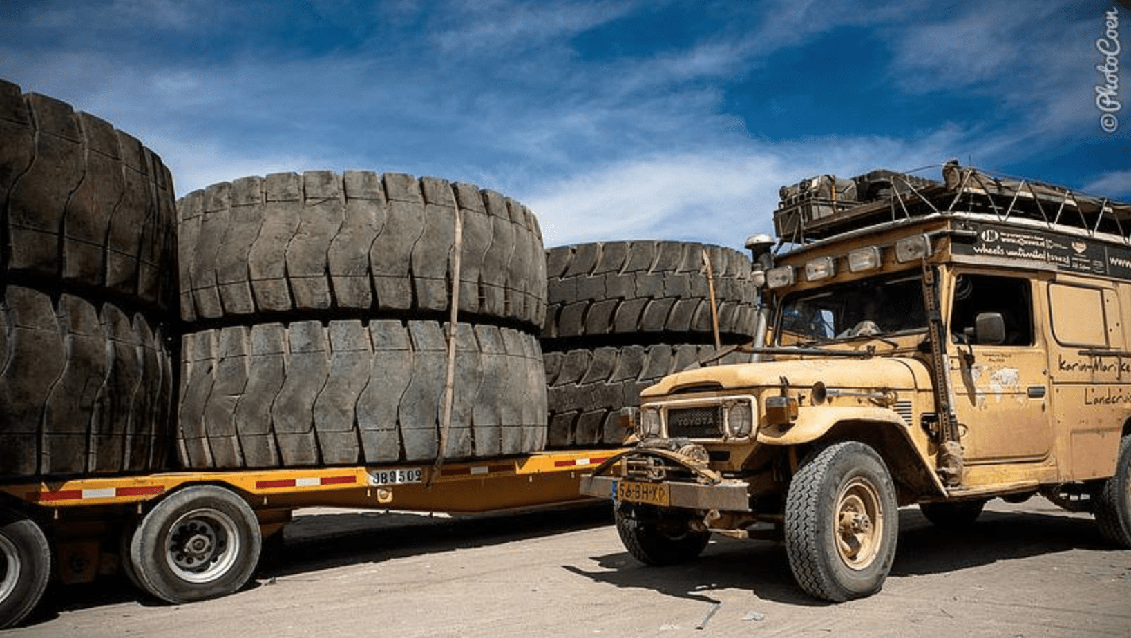

I hear you thinking, “What, another post on tires? You’ve got to be kidding me! There must hundreds of them on the Internet.” Yes, you are right, another post on tires. But this time I am writing it. Why? Because we get many emails and messages from 4×4 enthusiasts and overlanders asking us what type of tires we use, or why our Land Cruiser has such skinny road tires.

Why My Fondness For a Skinny, High Tire?
Screen Shot 2015-04-07 at 1.44.17 PM
I think it all started with my first car, a Citroën 2CV. They had absurdly thin, high wheels. Once, we had serious snow. When driving into town I saw big, luxurious cars swerving into problems in corners. This was mainly caused by the weight of their vehicle and the fact that it had rear-wheel drive. Meanwhile, the 2CV was cornering without a problem.
Okay I hear you; a big-ass Land Cruiser is not the same as my ‘ugly duckling’. You are right, but the principle remains more or less the same. Stick with me and let me explain.
