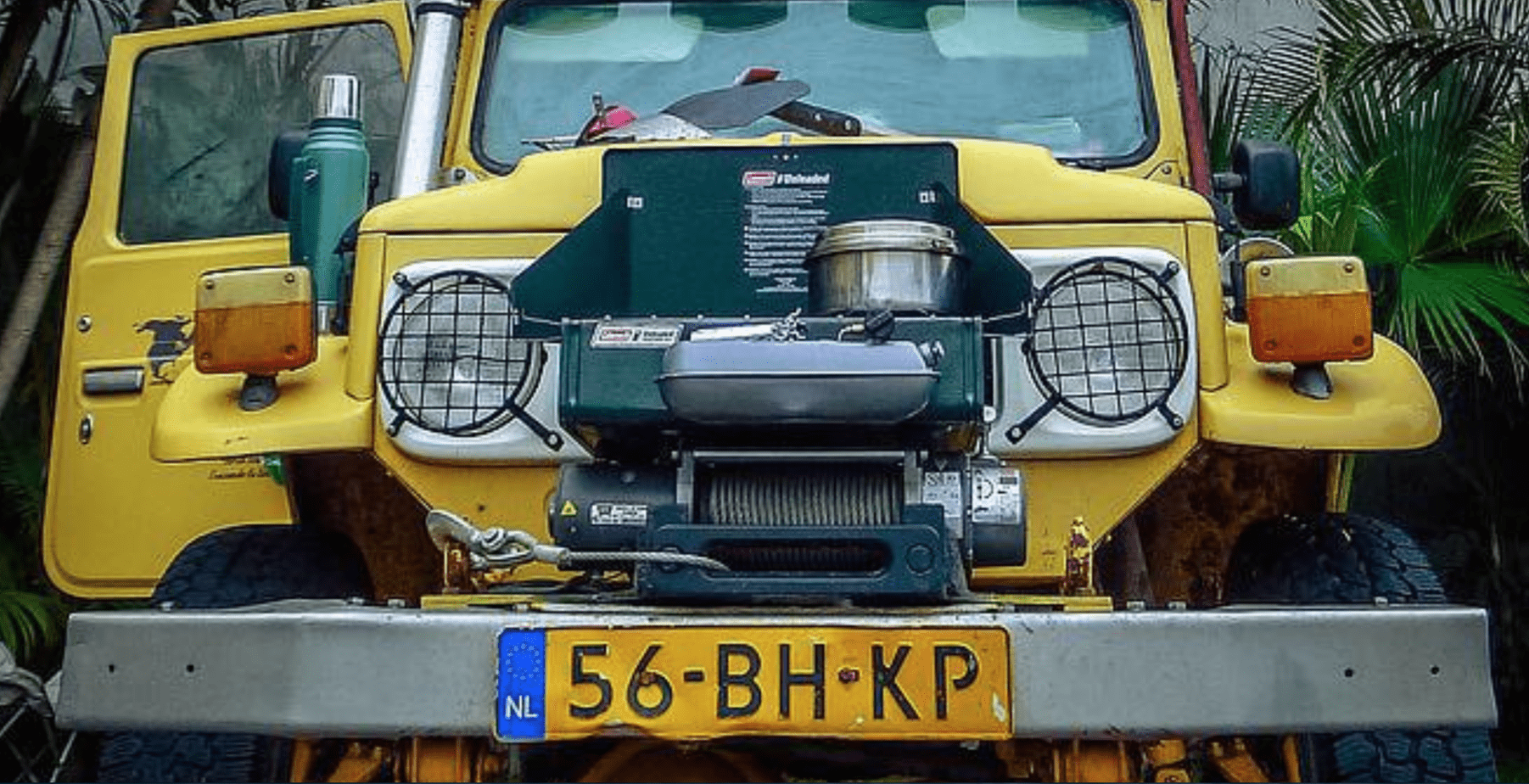

Prior to departing on our long journey, we hadn’t actually talked about what cooking equipment we’d bring. What we did know is that we wanted to keep things simple and mobile, and that we didn’t want to build a kitchen inside the Land Cruiser. We wanted to be able to cook inside as well as outside.
1
Why we Cook on Gasoline – the Coleman Stove
I was scanning the shelves, when all of a sudden my eyes fell on a couple of rectangular, green metal boxes. When I opened one of them, I knew we had found our kitchen set-up. Two old Coleman 425F stoves were stacked between a number of military diesel stoves. These old models with the fancy red tank instantly appealed to us, so we bought one. Together with my friend Bas I thoroughly cleaned it and fired it up with white gas. It burned nice and clean. Great.
