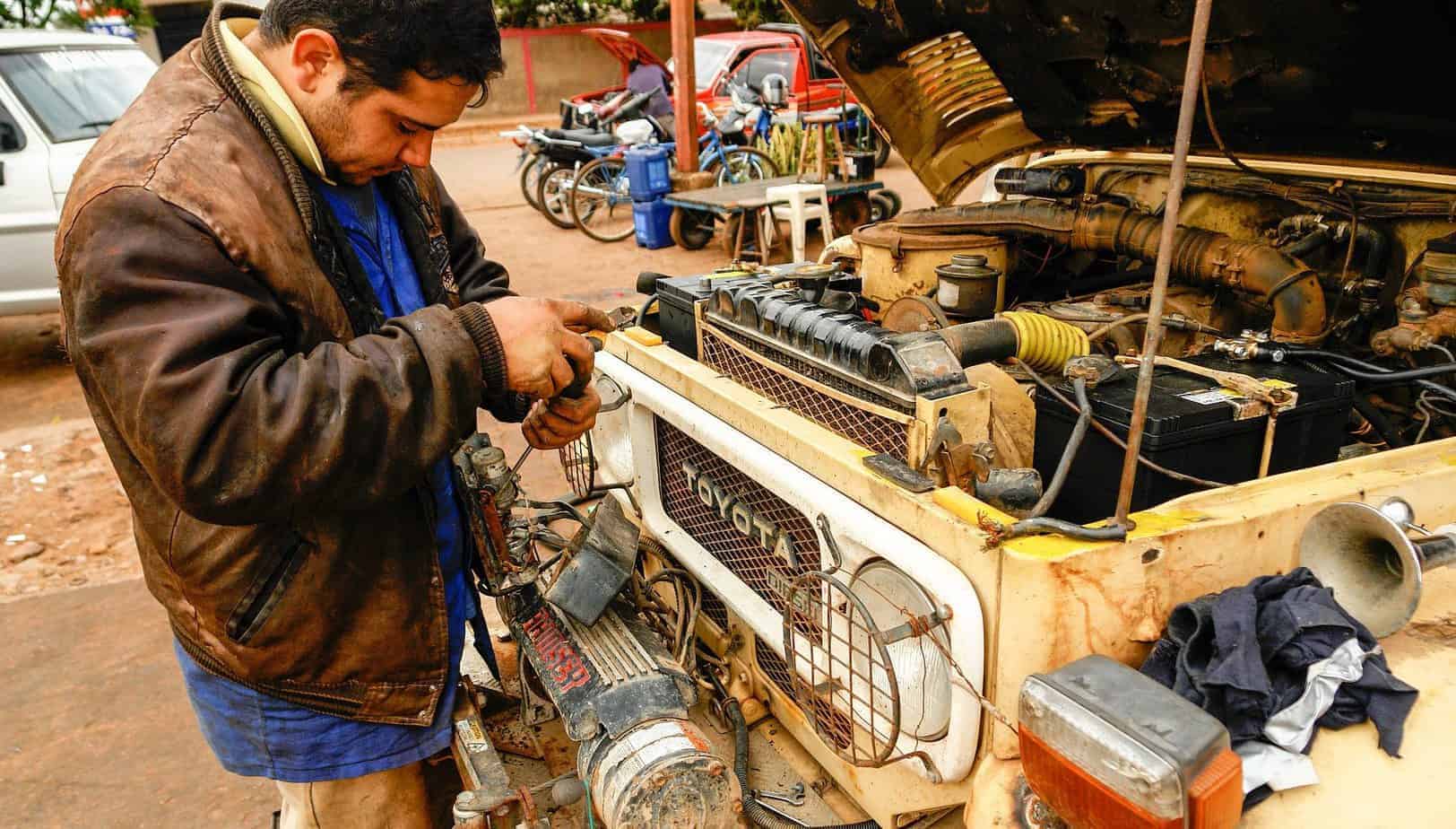

The green ones lasted only three years before exploding one evening, leaving us stranded in one of the coldest nights the region had had in decennia. After we had limped the Land Cruiser from the Brazilian border into Paraguay to buy new batteries, I learned that the main lead of the unfused winch had rubbed against the bodywork for I don’t know how long, which had now shorted the system.
CBW_EP_batteries_07CBW_EP_batteries_06
Paraguayan Rockets
It was a good time to upgrade the batteries to a maintenance-free version: batteries with a small, dark hole to peer into and see either a green or red glow. I was done with the tricky way of opening the green monsters. Maintenance-free sounded like the perfect method to me.
The Rockets from Paraguay lasted five years before capitulating. Vibration had worked its way to the cable that connects the negative lead to the chassis, and created a loose ground. Years of driving on South American roads is tough on every vehicle and its components. In Suriname the only suitable option were a couple of AC Delcos, which—I was told a few years later—had been sitting in a shed for way too many years.
