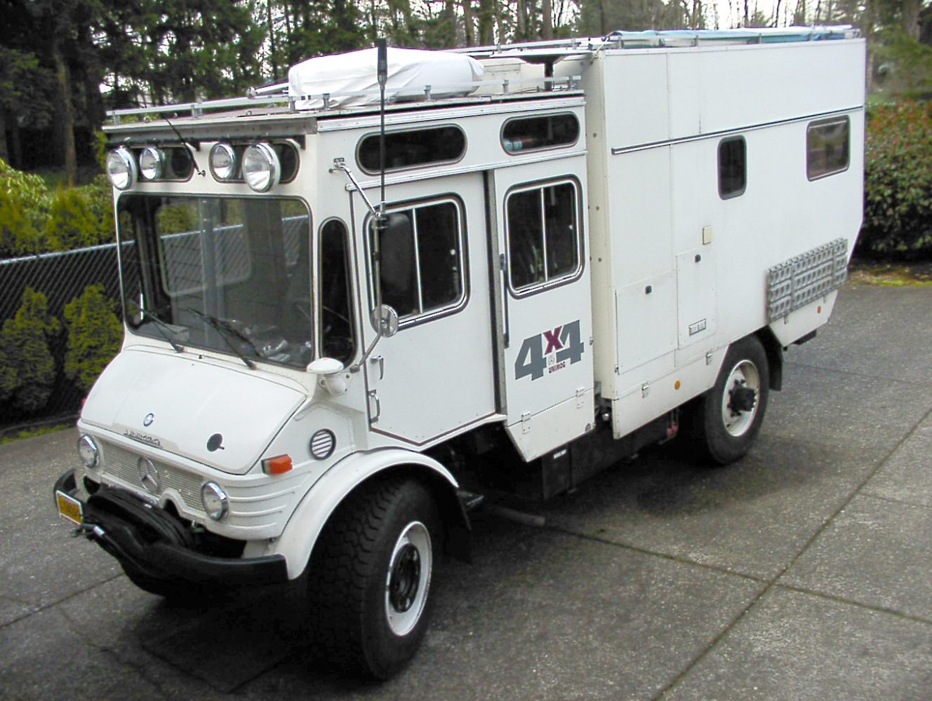

This is a bit of a comparison test. In 2002, I took my 1977 custom Unimog camper through this same area on one of her first U.S. trips.

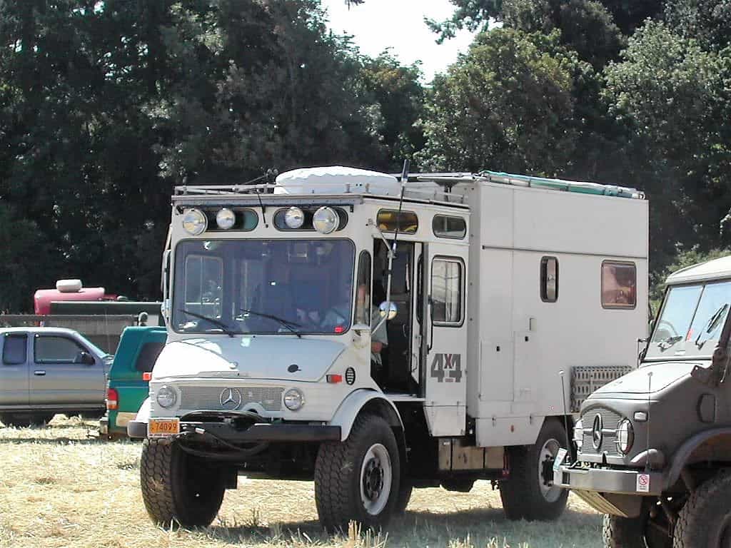

CamperMog was a splendid piece of equipment. Coach-built from a 416 Unimog traction head unit for the Netherlands Train Authority, the estimate was that the railroad had spent around a quarter-million dollars building her. She was later bought surplus and rebuilt into a Sahara expedition truck by one of the Netherlands’ more prominent overlanders. I felt fortunate to have been able to import her and kept her for 7 years.
CamperMog ended up being sold, but my big-camper interests remained strong. So when I was able to finagle the use of one of my favorite big rigs—one 30 years newer than my Mog—I was enthusiastic. And it didn’t take long to see that replicating one of my CamperMog trips in a modern truck that is conceptually and dimensionally very similar might make for a fun investigation. While I’ve scarcely changed in 30 years (scoff, chuckle), I was pretty sure the state of the art for big offroad camper haulers had.

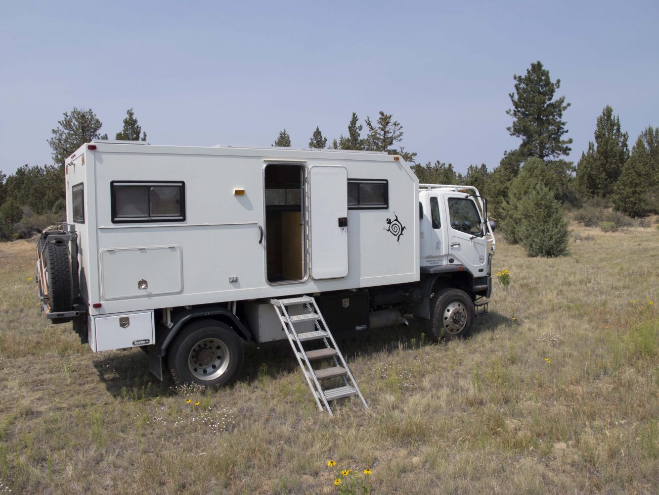

Meet the star of the show.

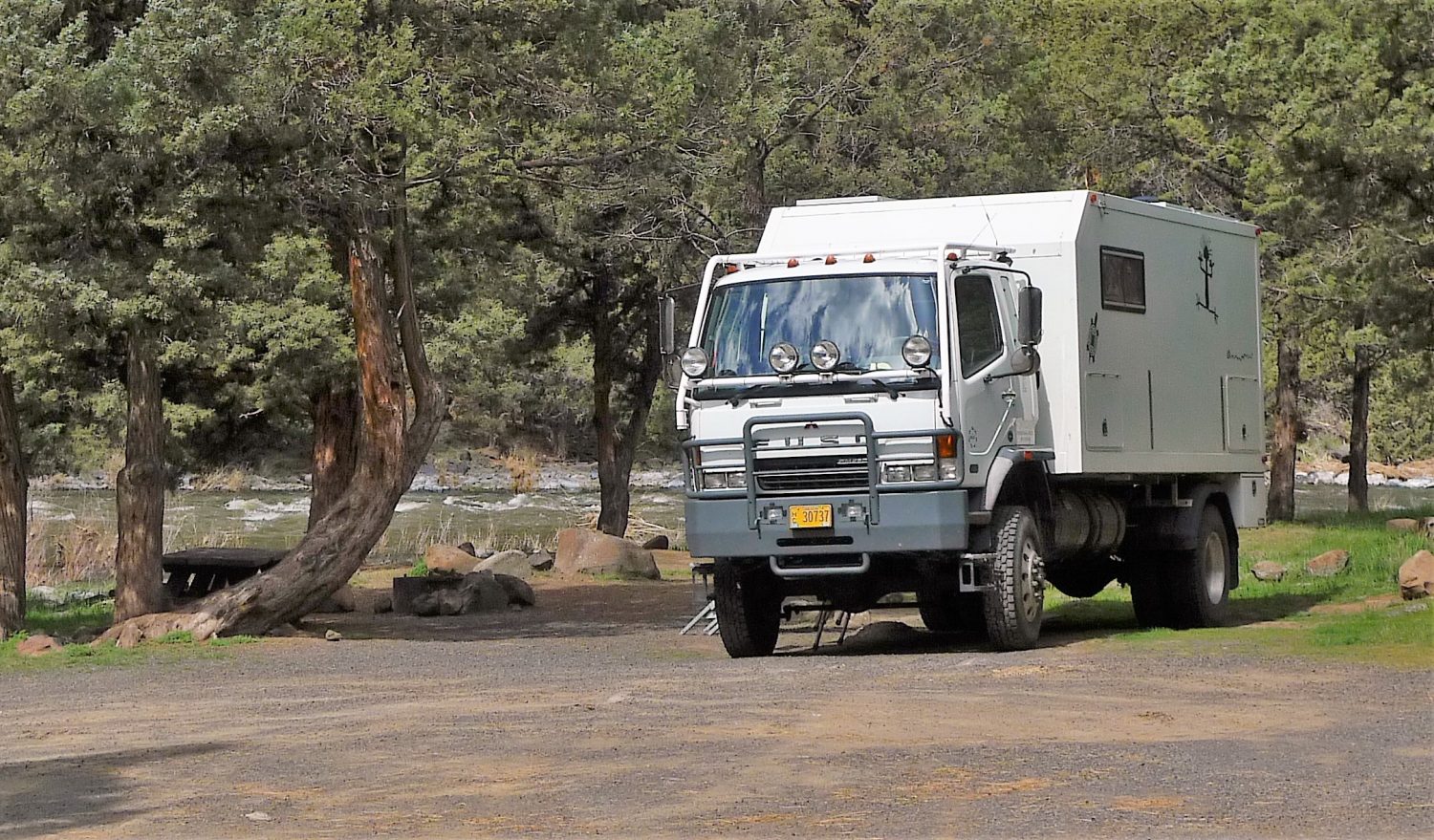

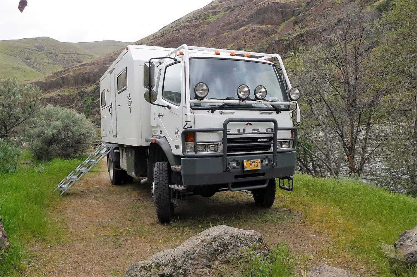

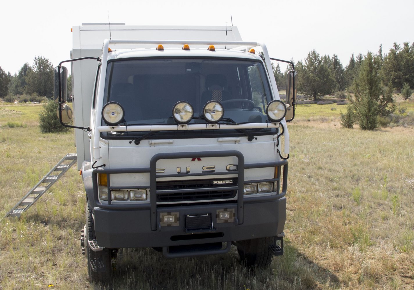

This is a 2007 Fuso FM260, owned by my good friend John Rhetts of Bend, Oregon. John and I go back a ways, and I go back with his camper even further, back to the point where the idea got thought up.
Because of Unimogging, I knew of the late Darrin Fink, a rancher outside Douglas, Wyoming, with wicked fabrication skills and a fleet of Unimogs. But while he recognized their advantages, he had no difficulty in seeing their weak points as overland trucks. And in particular, he wasn’t keen about starting out with any chassis that would be (in pre-U500 days) a minimum of 25 years old by the time he got it.
After completing a U1300-based camper, Darrin, through his company (Renaissance Universal Fabrication—RUF), built a Fuso FG camper which impressed the Mitsubishi-Fuso’s U.S. engineers enough to gain their cooperation and get a nice writeup in their company magazine.

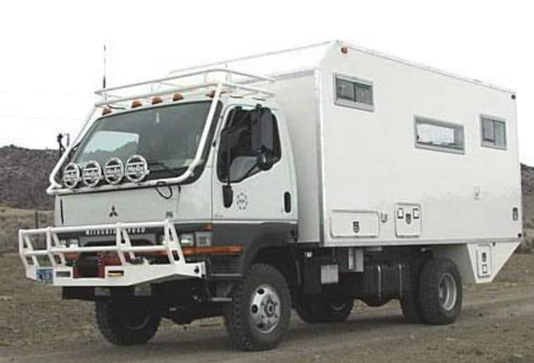

But Darrin didn’t like some of the changes made in the 2005 FG redesign, and was also looking for something that could handle more payload. His good relations with Fuso led him to stick with the brand and he decided that the Fuso FM260 would do the trick.
There was only one problem: it’s a two-wheel drive truck. So Darrin worked with the Fuso engineers, a mechanical engineering professor he hired as a consultant, and the engineers at Marmon-Herrington to develop two from-scratch 4WD setups for two FMs he bought, complete with dual-range transfer case and custom Dana axles.
It all worked out fine and Darrin, having done the research to find what he believed to be the best possible material, had two sizable empty cabins built to his specifications and then added their systems and interiors. After owning different vehicles, including two EarthRoamer XV-LTs, John arranged to buy the second of Darrin’s converted Fusos.

I’m sure John figured, “Well, if he could drive CamperMog all around without incident, he should be able to drive this.” And he was right. The Fuso’s similarities to CamperMog are amazing. The rig’s height and length are remarkably close. CamperMog had a true double cabin and a bit of a hood, so the Fuso has the smaller bumper-to-back-of-cab measurement. It offsets that, though, with a longer cabin, so that they end up about the same length. Both ride on similar size tires, both on 22.5-inch wheels.
The cabs have about the same width, big mirrors, huge windshields, and excellent visibility. The Fuso has the easier cab entry, but once inside, things felt a lot the same. CamperMog, being created out of a 416 traction head, did have portal axles in the front, but the railroad was happy to exchange some ground clearance for increased reliability and payload by specing a “regular” axle and hubs for the rear axle.

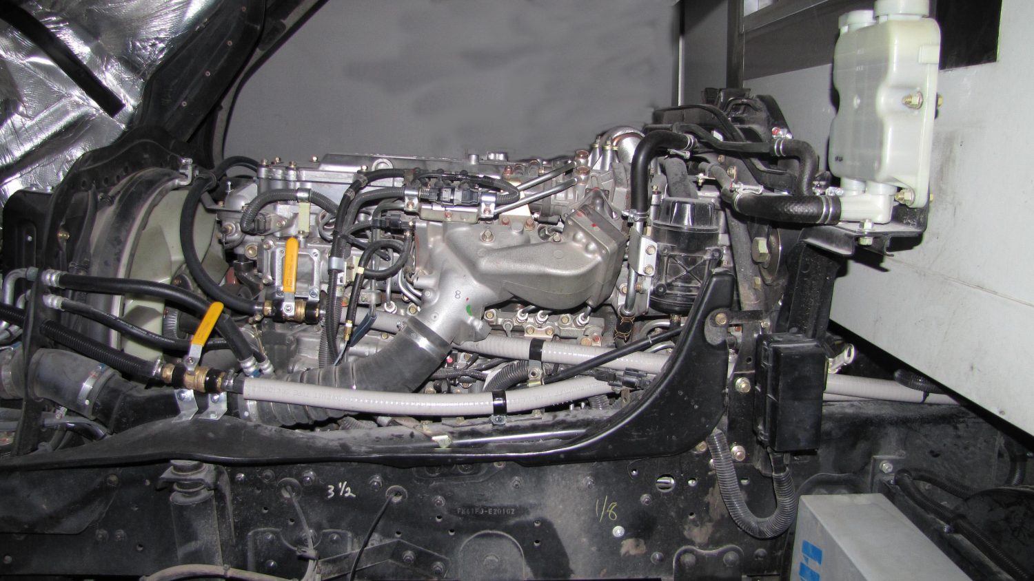

The FM has an intercooled turbocharged Mitsubishi 6M60 inline six that displaced 7.5 liters. Rated at 243 horsepower and 516 torque, it’s not exactly quick, but it was still a revelation. Even moving more weight, acceleration was much better and speeds were held on moderate grades that would have slowed my Mog. On long steep grades, however, the Fuso would eventually end up climbing the grade at the same 35 mph as CamperMog. It took longer to slow and got up to speed quicker, but if the grade was long enough, the Fuso performed pretty much like all the heavy trucks. The difference was that the Mog slowed even where most truck traffic didn’t, thus creating a bottleneck on busy highways. The Fuso slowed in the same places as all the over-the-road trucks, which meant that there were routinely passing lanes for faster traffic.
But it was the cruising speed on level ground where I saw the most practical difference. CamperMog had a top speed of 55 miles per hour. That was not a result of the engine’s meager horsepower; it was a result of the gearing. Even going downhill, the Mog couldn’t go any faster because it was up against the engine redline. From the factory, John’s FM was geared to go 79. Changes to the tires and driveline during the 4×4 conversion changed that to a Vmax of 85 mph, and the Fuso can, should one be willing to pay for the fuel, manage a sustained 75-mph cruise.
The bottom line is this: the modern Fuso did not routinely impede traffic; the older Unimog did. On a freeway or an empty two-lane, this is not a big deal, as faster vehicles can work around you easily enough. But on a two-lane with enough oncoming traffic to make passing impractical, a max-55 mph truck is a public nuisance and annoying to drive. I hit what passes for rush hour on US 97 heading back to Bend from Madras, and spent the time thinking about the joys of being in a truck that kept up with with traffic.

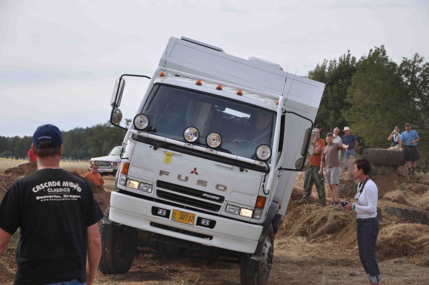

Off-pavement travel in a big trail truck is an interesting exercise. Obviously, you can’t go where the camper won’t fit. Most of these campers are about 11 feet tall, with many being taller. They’re generally 7 to 8 feet wide. And while both CamperMog and John’s Fuso are in the shorter half of the class, tight trails will still cause a good deal of backing and filling to make turns, even with a cabover’s good turning circle.
That said, if the trail has the room, these trucks are pretty competent. They’ve got lots of ground clearance, 40-plus-inch tires, and enough power and/or low gearing to make good progress. The big tire sections help in sand. Big rocks aren’t all that big to a truck this size and washboard doesn’t bounce 11 tons like it does a Tacoma. All in all, there are lots of open trails where the big expo campers would be a plausible and comfortable choice, and when simply handling an unpaved road, they are plush.
This is probably a good time to point out that a giant expo truck is only “giant” in the context of more commonplace expo trucks. My Mog and the Fuso are indeed big overlanders, but they are small and compact recreational vehicles. The L x W x H dimensions of the Fuso are, for example, almost identical to most of the Sprinter-based RVs sold as the “downsized” alternative for RVers, with the vast majority of on-pavement RVs being much larger.
But it’s still hard to stop thinking “What if I do get stuck?” Recovering one of these trucks if something goes wrong isn’t going to be easy or cheap. But we’re not ‘wheelin here, we’re overlanding, and the big trucks can do this splendidly. Both CamperMog and the Fuso have been to some pretty remote sites, with CamperMog having multiple Sahara expeditions and the Fuso putting in a 3-month expedition to Alaska and the Yukon along with lots of desert camping.

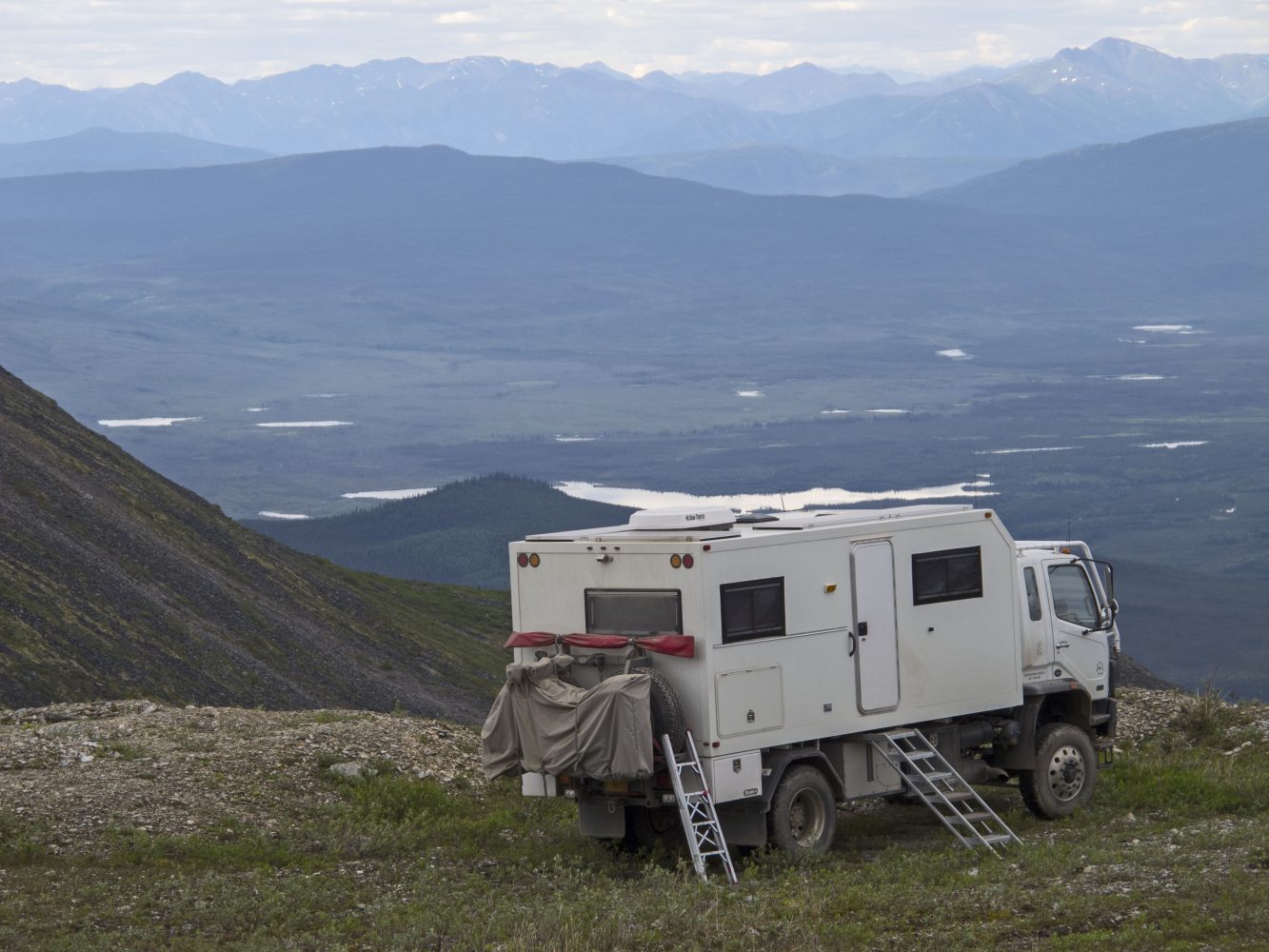

That’d scarcely be highest and best use, though. That would be more like the 3-month trip John took to Alaska and the Yukon in the truck. The adventure was a great success, free of incident and hardship, even when traveling through 18 inches of snow on the North Canol Road on July 8th. It was the sort of epic trip that simply could not be pulled off as well in a smaller, less comprehensively equipped overland truck.

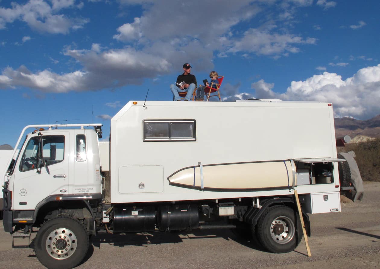

The Fuso’s cabin is a robust place. It’s over 16 feet long, a bit less than 8 feet wide and about 7 feet tall on the outside. Builder Darrin Fink had his two RUF FM cabins built by Martin-Marietta Corporation out of Transonite® composite panels. Transonite is functionally similar to a variety of composite panels in having thin outer panels of a material (usually fiberglass in the camper-building world) separated by a thicker middle layer, generally of foam or honeycomb. And as you’d guess, the Transonite panels share the usual composite panel advantages of being lightweight, repairable, and low on sound and thermal transfer.
The cabin uses Dometic/Seitz-style windows that combine plastic framing with dual pane acrylic plastic glazing. These windows are a common selection in expedition cabins, offering low heat transfer, integrated shade/screen cassettes and pretty secure latching. The two main drawbacks are that the scratches the window plastic picks up need to be periodically polished out and the screens aren’t teensy-bug-proof, but they are generally a decent choice for less money than more elegant offerings. The Fuso has three large slider windows and a big awning-style window by the bed.
The entry door seems just the right size; at 26 inches wide and 66 inches high, it’s easy to get through without wasting wall space. The retractable folding steps are easy to store and a solid way to get up to the cabin, which, given the Fuso’s big tires and the need for a flexibly-mounted subframe, is a ways up in the air: it’s 6 steps and 55 inches up to the cabin floor.
Several windows are big enough to get out of in an emergency that blocked the door, but expedition vehicles are traditionally also supposed to have an emergency connection between the cab and cabin. This is so you can drive off in the truck without going outside when bandits or bears are threatening your safety. I’ve never had occasion to do that, but there’ve been about a thousand times I wanted something left in the cab and have enjoyed having good passthroughs to fetch it without going outside. John’s Fuso FM has a rather nice opening into the cabin that is plenty big to get through without much contortion.

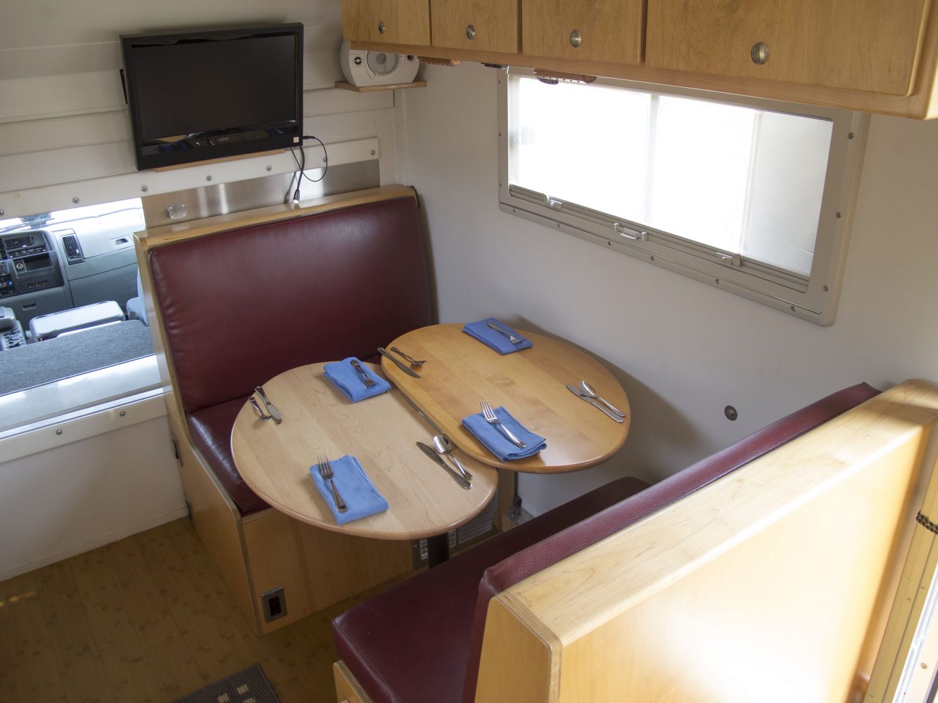

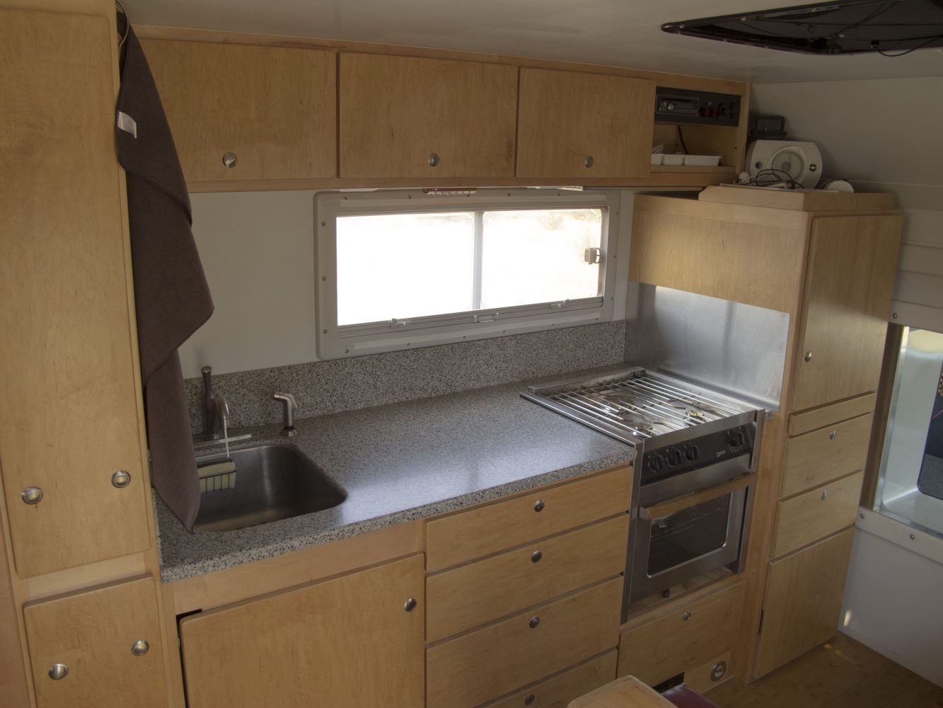

Cooking is no issue either, with a wide, deep stainless sink, plenty of open solid-surface countertop, and a three-burner Force 10 propane cooktop above its oven. There’s enough elbow room to undertake any meal, along with enough space and hot water to clean up after it. And with the space heating—quiet and nicely ducted around the cabin—covered by an Espar Hydronic D5 diesel heater drawing fuel from the truck’s 100-gallon fuel supply, the 20-pound propane supply provides enough stove fuel for a year’s worth of cooking.
The meals get served on a clever folding table that opens up to seat four, but then swivels and folds out of the way to provide a nice lounging area for two to sprawl. The high-grade vinyl-covered cushions are nicely padded, resulting in about as much comfort as you would expect on your living room sofa. There’s also music or a ballgame if you want it available from a satellite radio.

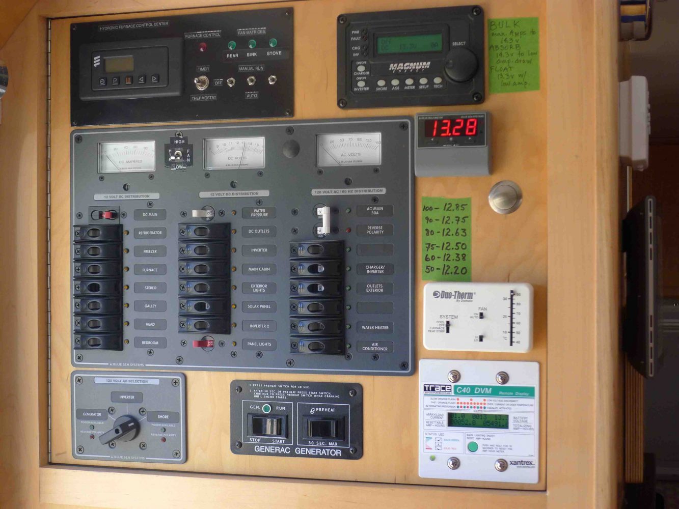

Plugs, both AC and DC, are well-situated throughout the cabin. Available power is considerable, with three AGM batteries, each having over 200 amp-hours capacity. Recharging those batteries can be done through a shorepower connection, by the 4KW onboard diesel generator or, most commonly, with nearly a kilowatt of solar power supplied by four panels on the roof. There’s comprehensive instrumentation which, in the case of my own boondocking, showed that the solar wattage collected stayed well in front of my use.

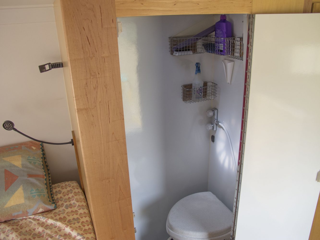

The cabin has an enclosed bath with shower, mirrors and soap/shampoo racks—all the comforts of home. Well, except for the fact that there’s a toilet sitting in part of the shower pan. This is John’s Nature’s Head composting toilet. Many, including John, are sold on the composting toilet advantages, and John started an extensive thread on the ExPo forums discussing them.
(http://forum.expeditionportal.com/threads/57461)
On my trip, the toilet was wizard, with no stink and no need to futz with it. It can be (and usually is) lifted out and set in the aisleway to provide plenty of space for showering. And that showering is pretty posh, given the Espar Hydronic can supply unlimited hot water up to the capacity of the tanks (105 gallons fresh and 33 gallons gray).

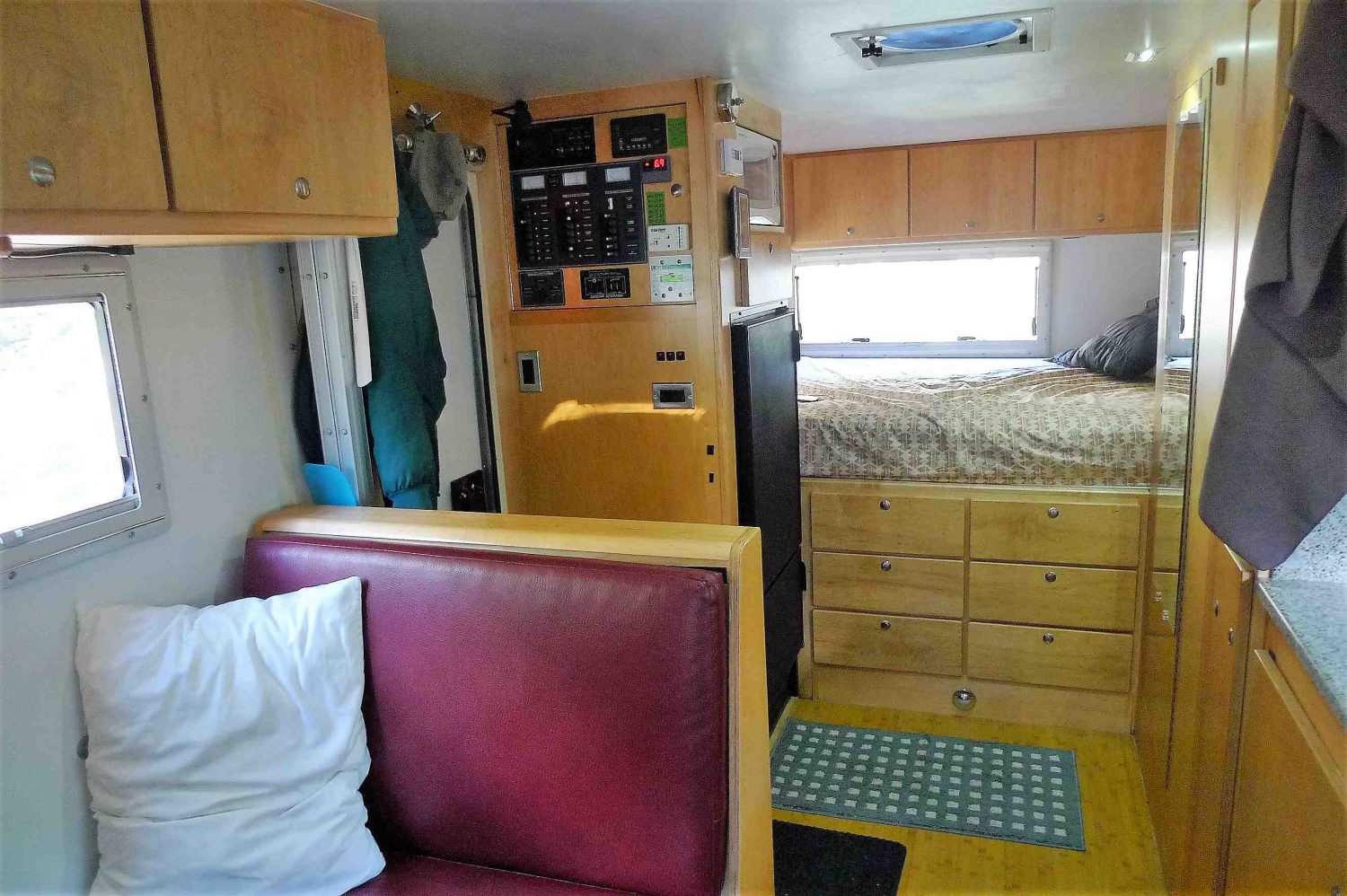

The queen-sized bed is also home-grade (see a theme developing here?), maybe even better, given that the mattress is 8 inches of high-grade natural latex foam. At the bed’s head (streetside end), there’s a nice catchment area for the alarm clock, paperback books, and other items nobody has anymore, or more relevantly, for your smartphone and the charger.
One intentional consequence of the big bed in the back is that it creates an impressive space under the bed that’s accessible from outside or inside. Raise the mattress level high enough and the space becomes vast. In some cabins, as in this Fuso, the space is used for secure dry storage. In others, it provides a “mechanical room” to house the majority of the cabin systems. Frequently, it’s both. But regardless of the use made of the space, it’s generally a most-impressive area.
And the storage space continues on the inside, with cabinets and drawers all over the place. Big drawers under the bed, big cabinets and drawers at the bow end, and overhead cabinets everywhere. The full complement of resident items—cookware, dishes, books, supplies, spares, etcetera—filled about a fifth of the available space. Everything personal I could think to bring along used up another few percent. I could have left for a month’s worth of solo travel with 60 percent of the storage space still empty.
