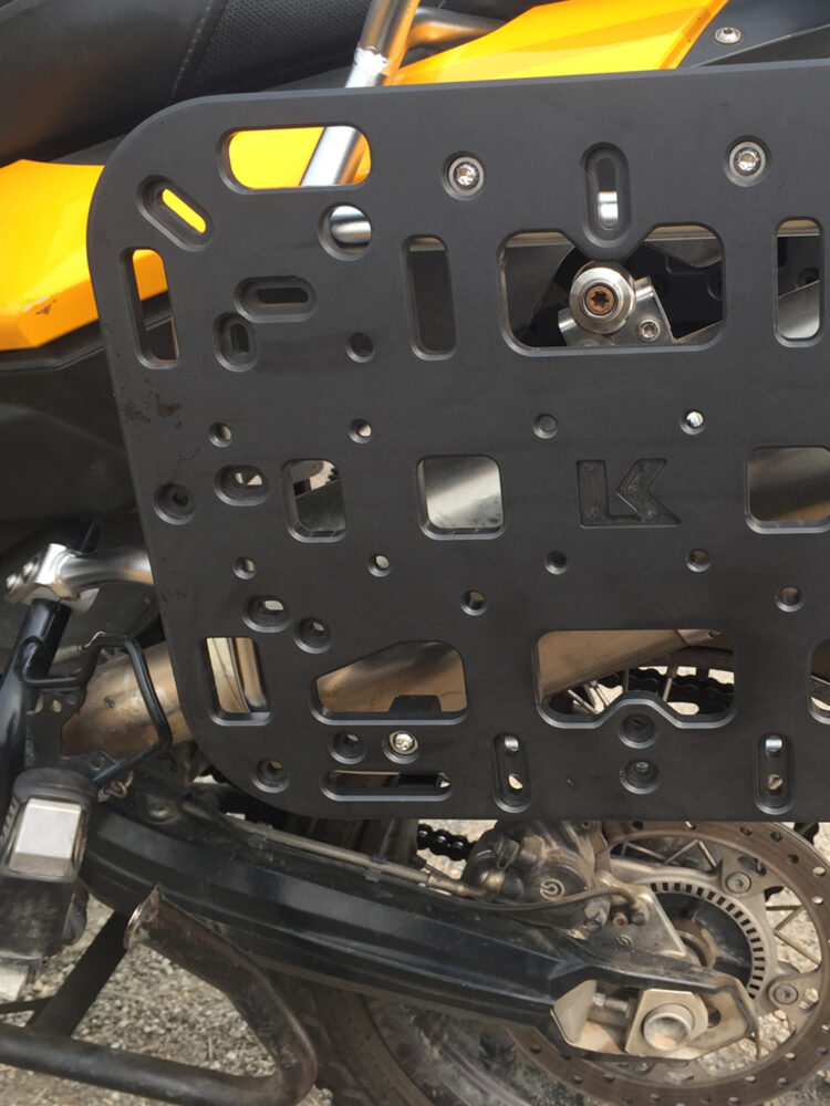

The OS-32s require a rack, whether mounted over the saddle using Kriega’s OS straps or using their OS platforms clamped to the rack. I chose the CNC-machined nylon-6 platforms (7/16 inches thick, 2.6 pounds each), which can also carry a Rotopax fuel cell. The stout panniers are nearly 6 pounds apiece, with the 1.9-pound OS-12 bringing the total weight to 18.9 pounds; the rack weight makes them the heaviest by far. They span 40 inches on my GS; fitting an OS-22 to the exhaust side narrows that by 1.6 inches.
Overlander system bags use clean rectangular shapes for a neat look.
Left: Kriega’s nylon platforms provide secure attachment points for their luggage, and are also designed to carry RotoPax containers.
Right: The Kriegas use two wide straps with G-hooks to both attach the bags and close them. Nylon platforms clamped to a luggage rack are the most secure mounting option; Kriega’s OS-Base straps are an alternate method.
Using Kriega’s instructions, the platforms were quickly fastened to the rack with four single-bolt clamps. Likewise, the 32s are simple to attach to the platforms using the top and bottom G-hooks on two wide straps that close across the roll top. Access requires releasing the buckles on those straps, undoing the top hooks, and opening the roll-top buckles—easier done than said. Integrated grab handles made full panniers a cinch to mount and carry. Interference from straps and luggage is unlikely with Kriega’s two-strap design and the ability to choose a sufficiently rearward luggage position. They lack strap keepers, but any surplus can be stuffed into the strap slots.

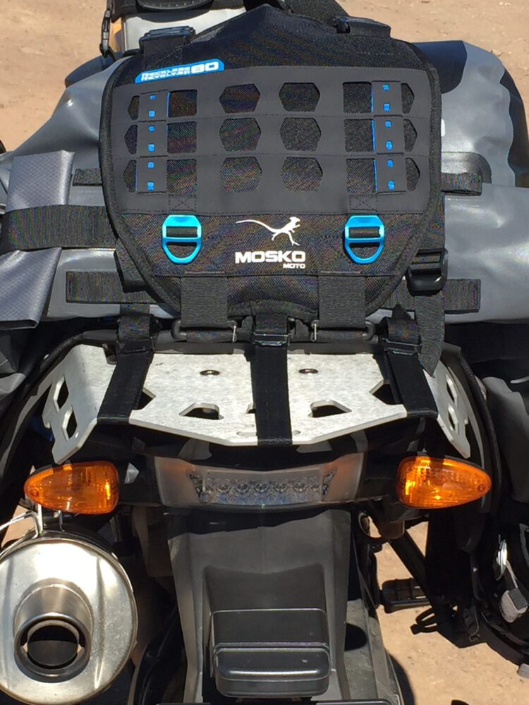

Mosko Moto’s Reckless is a modular system offered in several configurations, ranging from ultralight to RTW; this review addresses the standard version. The 1680D nylon covers the stiff polyethylene core of the R80 harness, which is strengthened with aluminum bars. It also incorporates a removable EVA foam base and rear fueling hole. Mounted to the harness are two holsters for the included 25-liter dry bags, and a beavertail comprising two overlapping flaps that grasp Mosko’s 22-liter Stinger dry bag. Auxiliary pockets (Aux Pox) holding 4-liter dry bags piggyback on the holsters. The structural components are crafted from 1680D nylon, with wrapped edges, rivets in stress areas, and Hypalon armor. Mosko uses 800D polyurethane-coated material for the welded dry bags, which feature light blue interiors. A tent pole bag, lightweight 20-liter dry sack, heat shield, and hardware for assembling the R80 round out the kit.
The latest Reckless 80L system from Mosko Moto incorporates adjustable holsters, removable auxiliary pockets, and replaceable straps.
Left: Three straps lash the rear of the harness to a rack plate, pulling against two forward straps to ensure the Reckless stays in place.
Right: The Revolver gets its name from the numerous side holster positions available for tailoring fit to bike and rider.

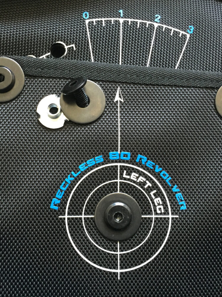

The “Revolver” part of the name refers to rider-selectable angle options for joining the holsters to the harness. Compass-like guides on the harness line up pre-drilled holes in both components for bolting on the holsters using T-nuts, screws, and washers. Once an angle was chosen, assembly was straightforward. Fitting the Aux Pox to the holsters was not—stiff fabric had to be pushed aside to align holes while mating a screw and nut inside a narrow bag. The V2.0 Reckless I carried on my Suzuki DR-Z 400S for the Idaho BDR had 4-liter pockets sewn to each holster; the Aux Pox added flexibility, as well as four more straps to the 22-strap system. Of those, two exit the lower end of the holsters to cinch the harness to a passenger footpeg or the subframe, and three hold the rear to the rack plate, cementing the R80 to the bike. The remaining straps keep things in place and unitize the system, fastening with side-release buckles or G-hooks; most have Velcro strap retainers to keep the load neat and safe. The Reckless works well, taking hard riding in stride, never budging or bouncing in the ruttiest, rockiest conditions. It weighs 15.7 pounds and measures 36 inches wide on my GS.
Packing the R80 was simple: the Stinger held my entire sleeping kit, and my chair fits perfectly in an Aux Pox, with everything else distributed evenly based on weight and need. The dry bags are easy to remove and carry to a motel room, 85 leaving the harness locked to the bike with an optional cable. Reholstering them can be a chore, even using the bottom grab handles. Partially unpacking, pushing in the bag, then repacking was easier. The waterproof Reckless is made in Vietnam and carries a limited lifetime warranty for sewn bags, two years for welded ones.

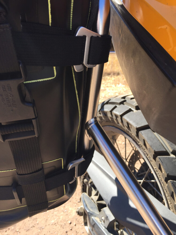

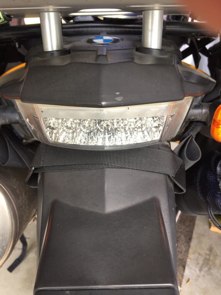

The pair weighs 4.5 pounds and is narrow at 35 inches across my GS. The Extremes mount with long straps and metal buckles at the front, two over-the-seat straps, and an over-the-fender clamping strap connecting the bags at the rear. The rear clamps didn’t fit the bulky GS fender well but did stay in place over challenging roads. Compression straps run back to front over the boot-shaped Extremes to further secure loads, and roll tops with four side-release buckle straps keep them watertight. With very few straps, and the ability to loosen but not release the compression straps, access to the bags is as straightforward as mounting them, and no straps are left dangling. Collapsible pockets on the back of the Extremes hold water or fuel bottles at the ready. Fitment to my GS required a heat shield, which is not included.
Touratech’s Extremes are the lightest of the test and hold the least gear, but are ably supplemented by the Adventure dry bag.
Left: While the metal clamps on the rear strap aren’t a perfect fit for the GS fender, they held tight through rough going.

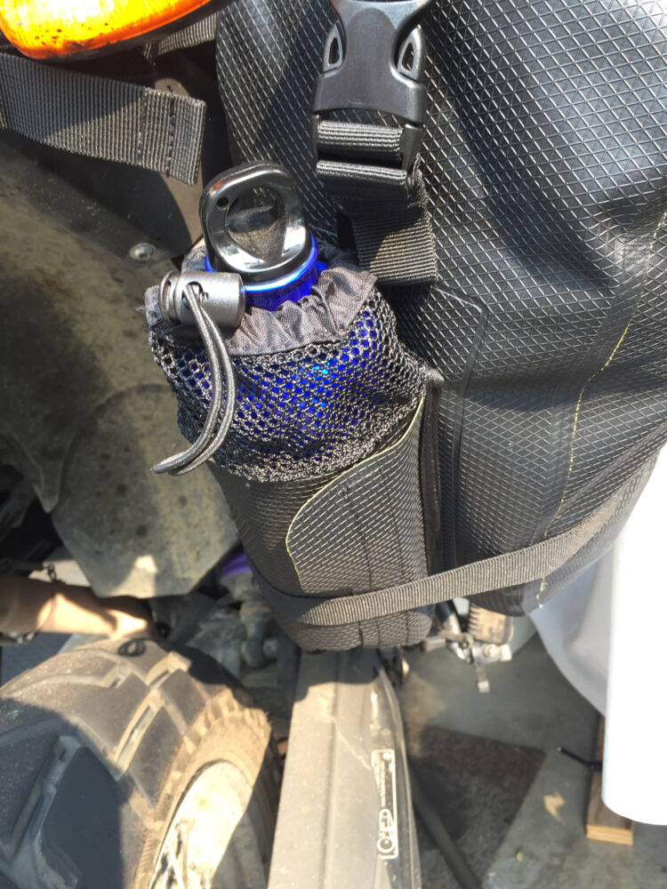

Right: The Extremes feature an external collapsible pocket for keeping water or fuel bottles handy.
Waterproof specialist Ortlieb makes Touratech’s Adventure dry bag, one of the few items in this review that comes in several colors—six in all. RF welded from a PVC-coated polyester fabric, the Adventure has an IP64 ingress protection rating (dustproof, water spray). Stiffeners along the full-length roll top facilitate a tight closure, while straps at the sides and over the top ensure it remains that way. Packed with my entire sleeping setup, clothes, and a camp jacket, it was secured to the rack using Touratech’s recommended Rok straps. The Adventure’s 1.8 pounds brings the total kit weight to just 6.3 pounds; it is 35 inches wide.
Packing the non-stiffened Extremes was hampered initially by their floppy sides, but they held the remainder of my gear with room to spare. The boot shape facilitated packing heavy items low and forward, and their small size and carrying handles make them the easiest to remove and remount. On the road—whatever the surface—they never budged or interfered; ditto the dry bag. Touratech’s lightweight luggage is a good value and carries a 5-year warranty against manufacturing defects.

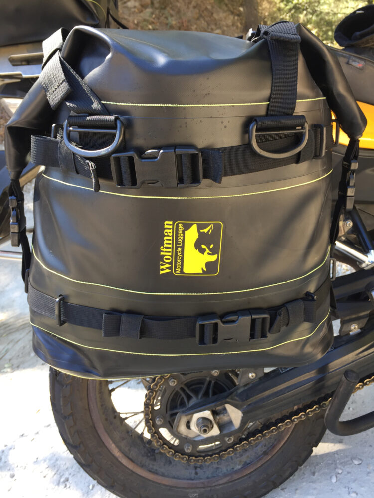

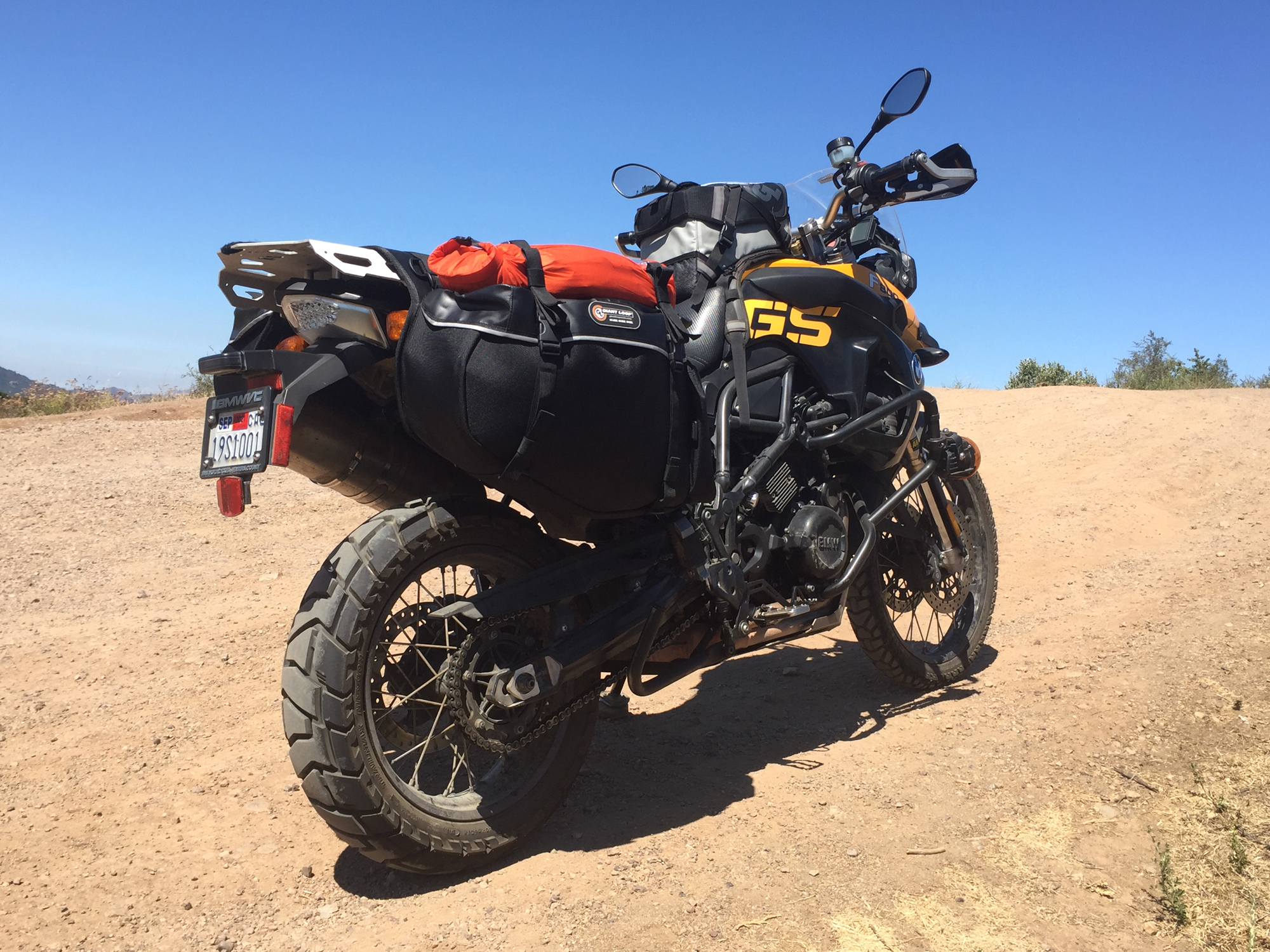

Wolfman | Rocky Mountain Expedition Saddlebags and Rolie Bag

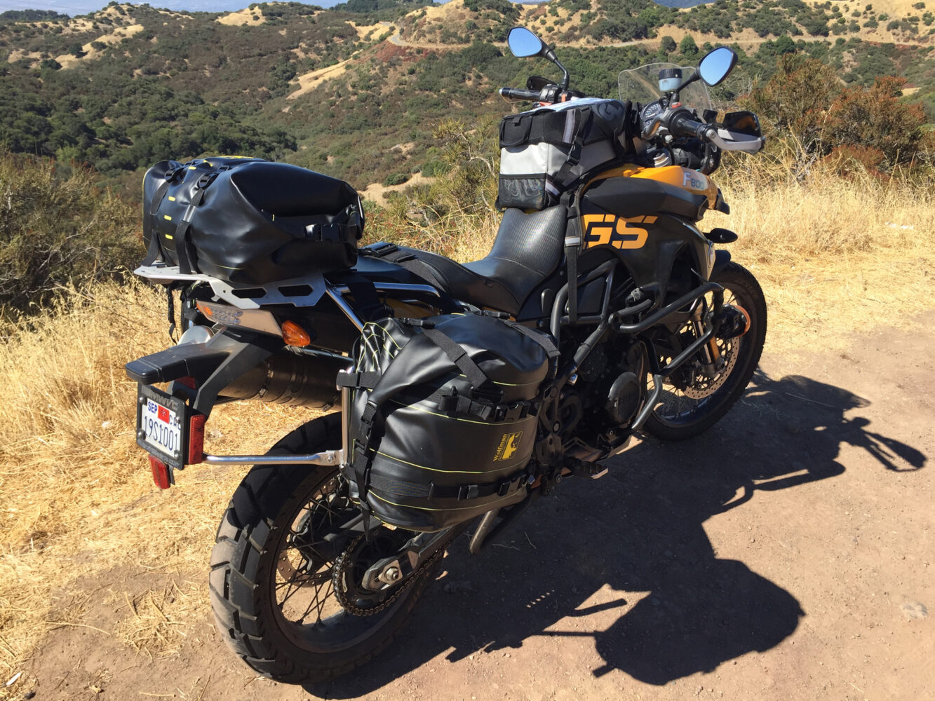

Based in Longmont, Colorado, Wolfman has created textile adventure luggage since 1992. Their earlier bags, like the Alfa model I tested when KLR650s owned the back roads, were sewn from sturdy fabrics but required a rain cover. Eric Hougen, Wolfman’s owner and designer, later pioneered making waterproof luggage with vinyl fabrics. Today’s waterproof, rack-mounted Rocky Mountain Expedition saddlebags are radio-frequency (RF) welded from laser-cut 840 denier nylon/TPU laminate custom-made in China to Hougen’s specs. The smooth, black material gets hot in the sun, but doesn’t hold dust and mud like woven fabric; water rolls right off.

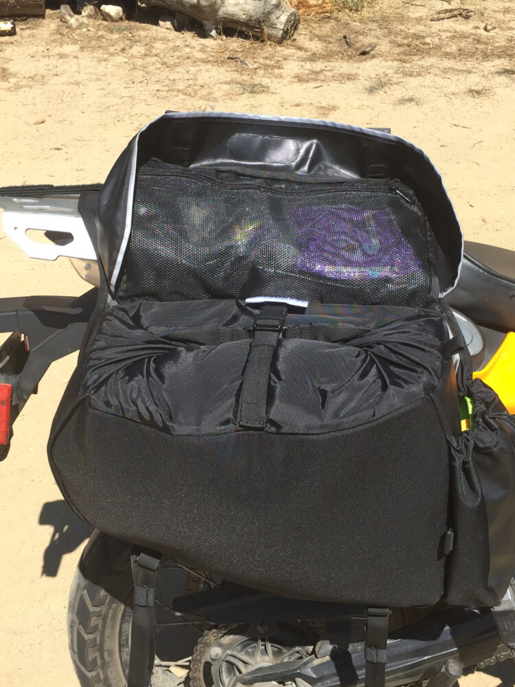

The roll-top Expeditions hold 30 liters each, with another 2 liters possible by omitting a roll on the top (three rolls maximize waterproofing). A 12-liter (medium-sized) Rolie bag of the same material brings total capacity into the target range. Strapped to the rack plate, it held my sleeping bag, mattress, and tent. The balance of my gear, including food for three days, disappeared into the yellow-lined Expeditions with space for more. Removable plastic stiffeners facilitate packing and maintain their wind-cheating shape.
Constructed from a custom material designed by Wolfman, these rack-mounted Rocky Mountain Expedition saddlebags feature a unique curved surface and easy access to the yellow interior.
Left: Their waterproof Rolie bags come in three sizes.
Right: G-hook straps hold the Expeditions to the rack and compress the load while two straps over the seat assist in supporting its weight. External D-rings provide attachment points for extra gear and accessories.

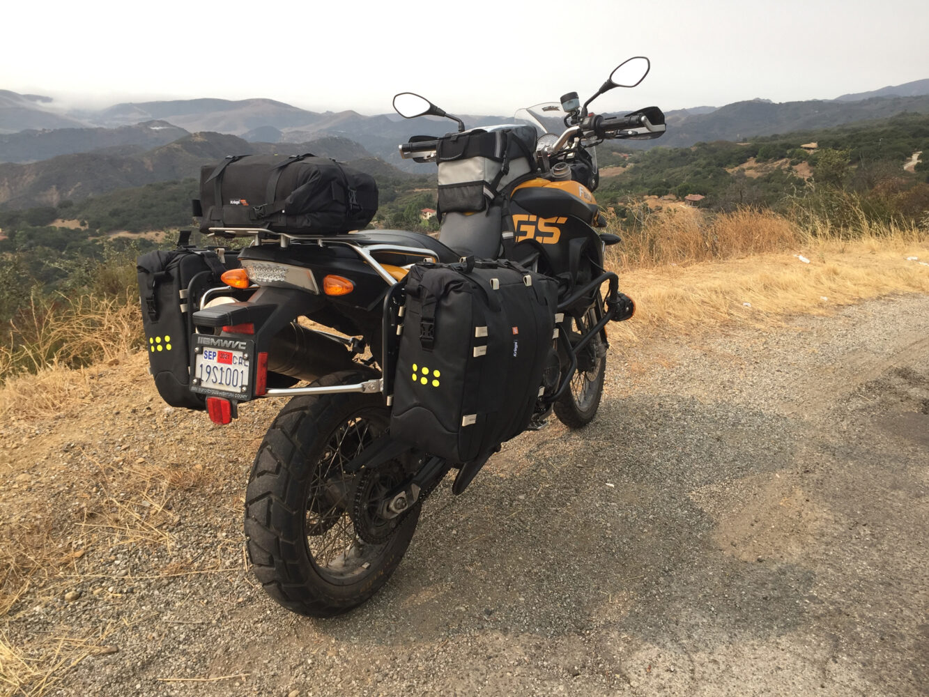

Mounting the Expeditions is simple: two over-the-seat straps center them, adjust their height, and distribute weight, and two horizontal straps with G-hooks secure the bags to the rack. Removable back panels protect them from scuffing, and lightweight handles simplify lifting and carrying. The roll tops fasten with 1-inch side-release buckles on the sides and across the top, while the G-hook straps compress and stabilize the load. Wolfman’s attention to detail shows in the straps: most are replaceable, and all have rolled and sewn ends to inhibit fraying. Wolfman fits elastic keepers to control flapping and interference.
The Expeditions were unnoticeable on the pavement, hugging the motorcycle like they were welded to it, never upsetting the bike through the turns. Miles of rough road failed to budge the gear, and my stash of snacks was just four buckles away. Removing and re-mounting the full Expeditions was more difficult than when empty, but the handles and seat straps made it workable. The Rolie bag stayed put as well, barely noticeable on the top rack. The setup weighs 10 pounds, plus 9 pounds for the rack, and stretches 41 inches across my GS. Wolfman continues to innovate in both material and design, providing an excellent, reasonably priced set of luggage for the adventurer, covered by a 1-year limited warranty.

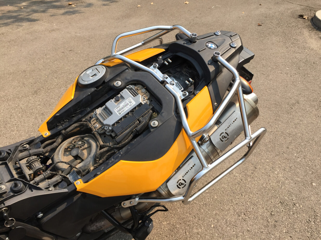

As a long-time adherent to the light-is-right approach to adventure riding, I’ve always looked askance at racks, mostly for the significant weight they add to a motorcycle. After all, they are steel and built for strength. The Touratech unit I sourced for this review is no exception—constructed of 18-millimeter tubular stainless steel, it weighs in at 9 pounds. I’ve come to like it, however, as it provides a better grab bar for hefting the bike onto the center stand than BMW did, and performed as required for testing the Wolfman and Kriega luggage.
Installing the three-piece system went quickly, requiring only a few basic tools. Two forward side sections clamp to the 800’s subframe, with the upper supports bolting to the original grab bar mounting holes. A third piece connects the two sections at the rear. All of the holes lined up properly, with no need to force the fit. The resulting structure is stiff, sturdy, and appears ready to take adventure-style punishment. On the GS, a rack plate can also be fitted but is not required to complete the installation. Made in Germany, the Touratech rack comes in the raw stainless shown or epoxy-coated black.
A feature of racks is preventing bodywork from getting scuffed up by panniers. Despite my efforts to prevent damage from rackless luggage with films and tape, the thousands of miles I’ve ridden my GS with such bags are indelibly recorded in the bike’s rear plastics. As tempting as this attractive and functional rack is, I’m still a stickler about weight and will likely remain a devotee of rackless luggage to save a few pounds. My weight obsession aside, anyone shopping for a rack should consider Touratech’s offering.

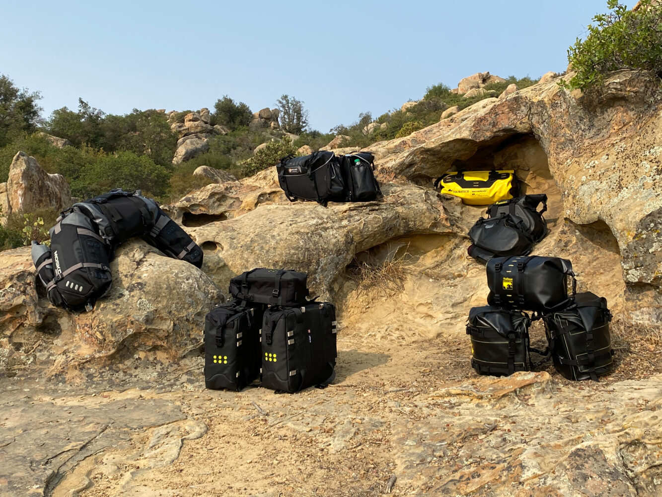

Clockwise from left: Mosko Moto Reckless 80L (V3.0) Revolver, Giant Loop Siskiyou, Touratech Extreme, Wolfman Rocky Mountain Expedition, Kriega Overlander-S OS-32 and OS-12.
This wouldn’t be a Best of Breed if all of the bags didn’t meet the criteria, and since all have something unique to offer, it’s up to each adventurer looking at soft luggage to assess how much capacity they require and in what format. Fortunately, for those who need more space, all of the systems can be supplemented with extra storage, and most are designed to easily accommodate it. The low-weight leaders— important to me as a smaller rider—are Touratech and Giant Loop. Giant Loop’s construction seems heavier duty, while the Touratech package is narrower but stores more weight up higher. It is also the least expensive solution. Mosko’s Reckless is heavier than both, which should translate into durability, but adds complexity with a raft of straps. I vote it best for pitching off the road onto a pile of rocks (been there, done that). Wolfman and Kriega both take a 9-pound rack penalty, with Kriega also being the most expensive set. Wolfman keeps things simple, clean, and easy to use for slightly more money than the Touratech Extremes. There’s not a luggage system here that I wouldn’t trust on a rainy ride, or for seeing me through a BDR. What’s the best setup? I prefer the Touratech Extremes and Adventure Dry Bag; it is the lightest system in the group and the least expensive.
