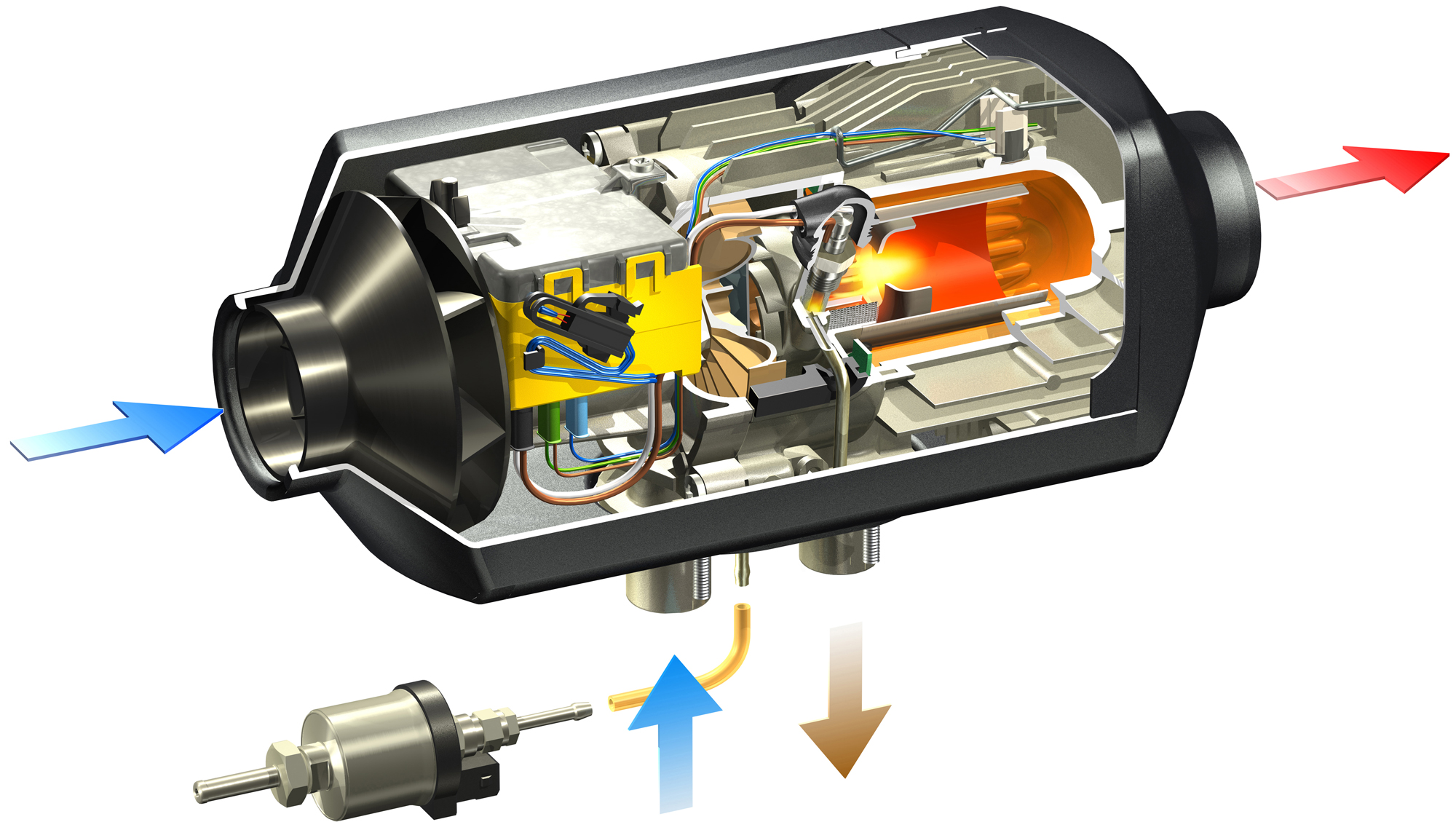

How Do Diesel Air Heaters and Gasoline Air Heaters Work?
These heaters function the same, except for the fuel that they require. They burn fuel to heat a heat-exchanger, over which air is blown into the cabin of your vehicle. Cabin temperature is adjusted via a thermostat that controles the speed of the internal fan. Some newer heaters feature integrated altitude compensation that automatically adjusts the fuel to air ratio, ensuring complete and proper combustion. Some older heaters may require the addition of high-altitude modules to allow for proper operation, above 5000 feet, for instance.
