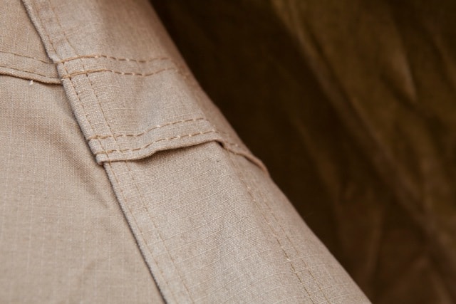

Stitching only makes up a small portion of the tent, but it’s crucial to the tent structure. Poly-cotton thread has what is called in the trade “maximum sewability”; in other words it’s less likely to have a malfunction on the sewing machine, and it stands up to wear and tear over time. When we fit tents to trailers and vehicles, part of our inspection is to check every seam for integrity. Our experience over the years has been that all the tents that are made in-house show very few stitching errors; technically and esthetically the stitching is perfect. Where we see problems is with stitching done by third parties. We see on a consistent basis:

When you first get a poly-cotton tent it’s always a good practice to lightly spray the tent fabric with a gentle shower of water from a garden hose. This will allow the cotton portion of the thread in the weave and stitching to absorb the moisture and swell up. This does two things, it tightens the weave of the fabric, and it also swells the stitching to fill the hole created by the needle.
When the fabric is sewn together the thread that is used is also poly-cotton, and because it has the ability to absorb liquid, when it does it increases in diameter and fills the hole created by the sewing needle. It’s important that the sewing machine has been fitted with a needle that is the same diameter as the thread to create a watertight seam. On occasion the stitching will weep moisture through the seam. The simplest solution for this is to rub some bees wax along the seam to seal it.
