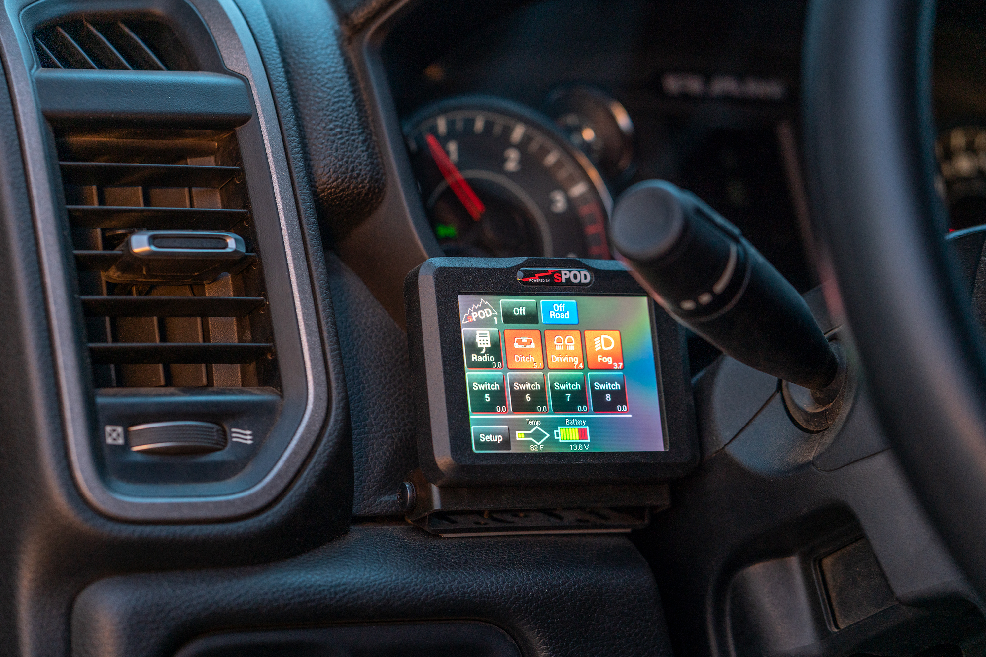

I routed the cat-6 cable through the firewall, up past the steering column, and to the controller, which I secured next to the steering wheel using the SPod-supplied bracket and some 3M VHB adhesive strips.
Step 3: Connect the touch screen controller to the Bantam.

By adding some 3M VHB adhesive strips to the mounting bracket, and wedging it in between the panels of the dash, it remains secure in a convenient location. I will eventually move the controller to a ball mount on the truck’s a-pillar for even easier use while driving.

Using the Bantam X is very easy once the unit is set up. The touch screen is responsive, but not like a smartphone: it requires a little bit of pressure to register “button” presses. Some of the sliders adjacent to the edges of the screen can be difficult to operate precisely, but that hasn’t posed any significant problems.
Upon initial setup, I had some issues with the touch screen operating correctly, so I contacted the customer service team at SPod, who quickly set up a service ticket. After returning the touch screen to the factory, they had multiple technicians inspect the unit, perform a panel of tests to confirm proper operation, and reflashed the most current version of SPod’s firmware. They promptly returned the touch screen to me and it has been functioning properly, however, I have come to the conclusion that the touchscreen is very sensitive to static electricity.
For instance, if I have a static charge built up on myself when entering the vehicle, and I touch the screen without first discharging by touching the vehicle chassis, I will often ground out through the Bantam’s Touchscreen. This often results in the screen going blank and needing to be unplugged and replugged into its Cat-6 power/data cable. When I do this, it restarts and then works correctly. I’m not sure if this is a shared experience among other users, and I would be interested to know if there is something that I can do to prevent this issue in the future. If I find a solution, I will post an update here.
