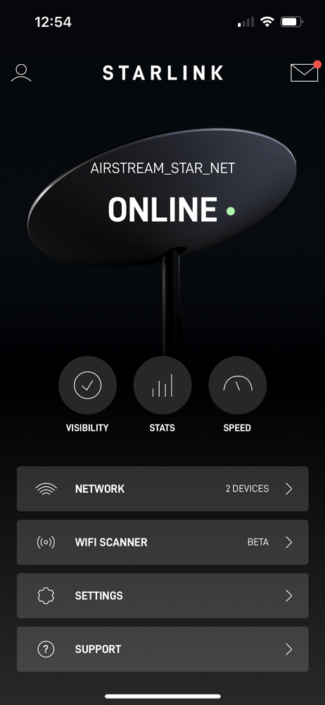

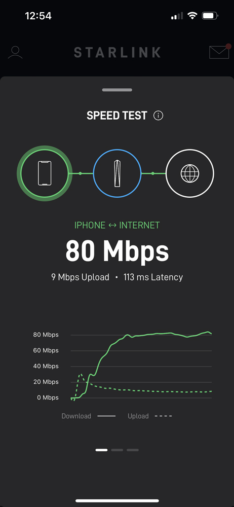

It’s interesting to note I did receive a notification on the Starlink app (on my smartphone) notifying me that because I was using the system outside of my designated service address, I might experience reduced bandwidth based on satellite availability. In practice, this has still resulted in approximately 80Mbps bandwidth down (12Mbps up), which is more than enough for streaming video services, video calls, and uploading/downloading photos. Generally, I’ve been getting 150Mbps+ download speeds.

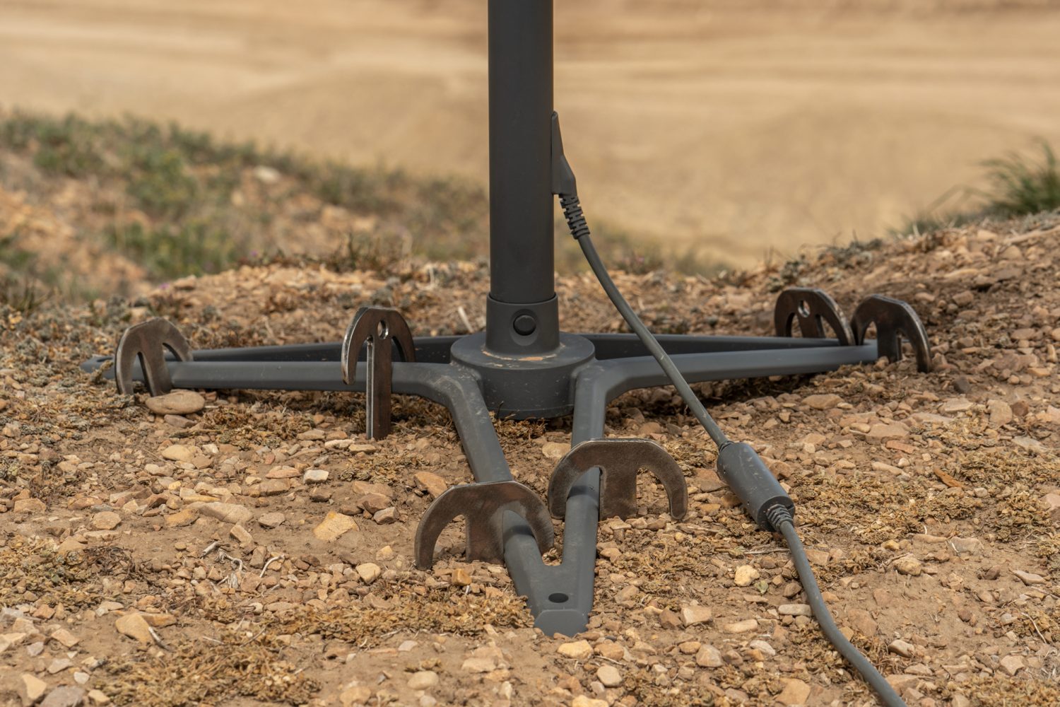

Step 2: Stake the base into the ground to prevent it from blowing over, and attach the dish.
starlink internet satellit dish base
Rough Camp Gear tent stakes secure the Starlink satellite dish for use in windy locations.

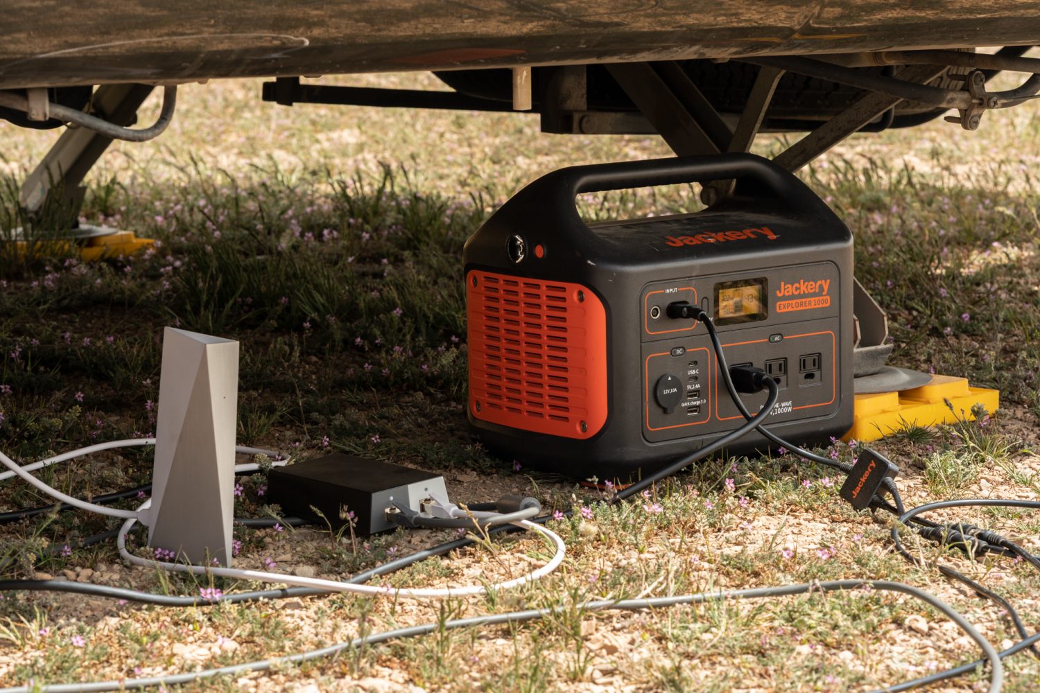

Step 3: Plug the system into an AC power source, in my case a Jackery Explorer 1000 battery bank that is powered by two 100-watt solar panels. The power draw from the Starlink has been approximately 70-90 watts, which is outpaced by the 135 watts of solar input from the two panels.
starlink internet router and AC power brick
Powering our Starlink internet with the Jackery Explorer 1000 – from left to right: router, AC power brick.
After plugging the system into power, the network connection is usually established within 5 minutes, often less.

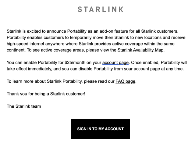

Starlink Portability Fee (updated May 5th, 2022)
Starlink has recently been sending out emails to existing customers, notifying us of a formalized $25/month portability fee. All users can now manually enable portability on their Starlink account, and it can be turned on and off as needed.
It’s important to note that if you’ve been successfully using Starlink on the road in a roaming capacity, you’ll need to access your account via the Starlink website and select “enable portability” to ensure continued connectivity at sites outside of your service address.
