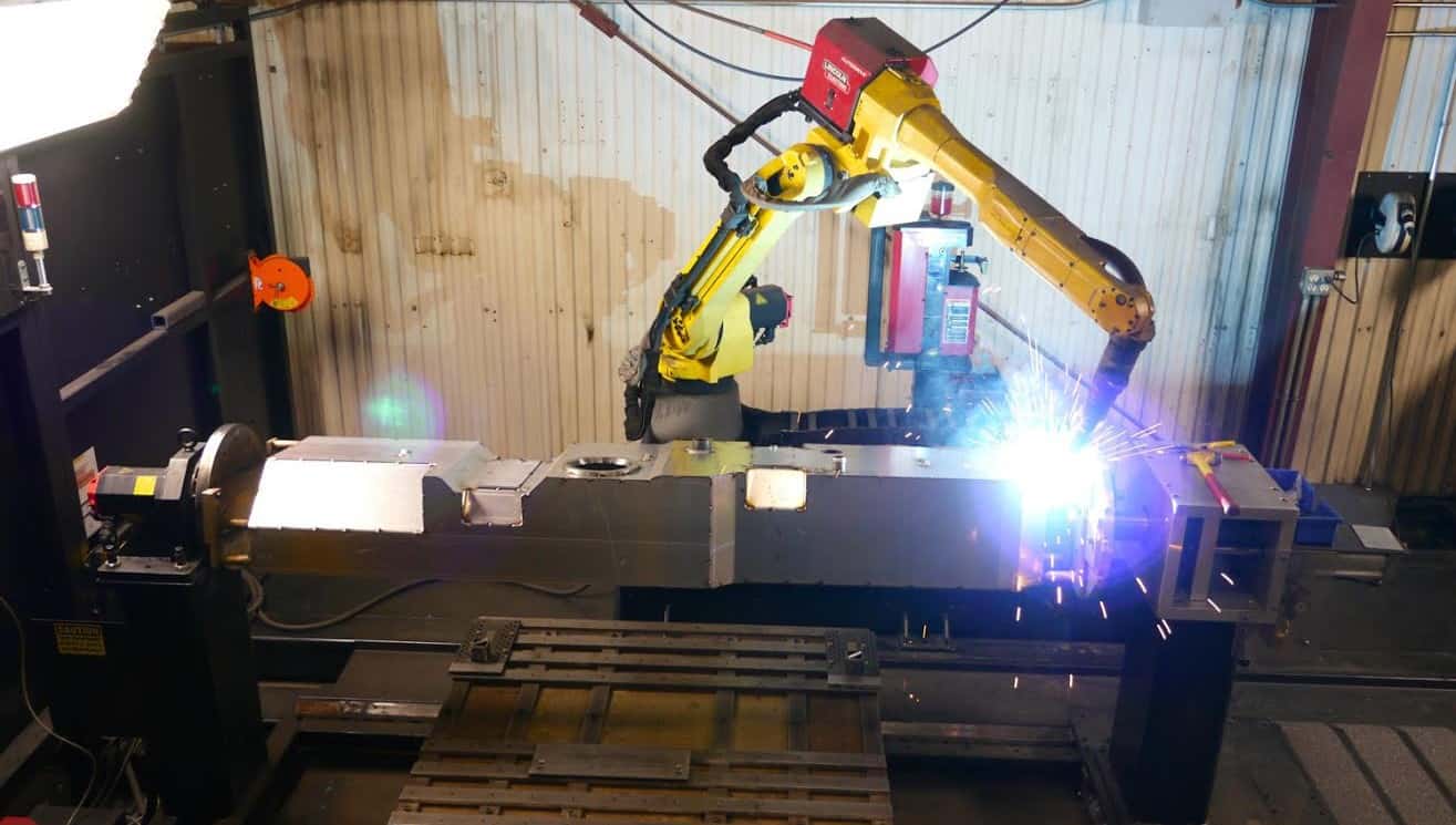

Bill Gaines was an engineer for General Motors for 10 years living with his family in Michigan, but he wanted to get back to his western base. Returning to Northern California, Bill started working for Travel Accessories, and later he took over their small-fuel tank division. In 1983, he founded Transfer Flow Inc. (TFI), starting small with only five employees. Transfer Flow has grown and currently employs 85. Initially making only motorhome tanks, in 1987 TFI started producing aftermarket in-bed and replacement fuel tanks for pickups.
Transfer Flow remains family-owned, having passed-down from father to daughter, with an average employee tenure of 15 years. Everyone I met at TFI seemed genuinely happy to be working there. Most of Transfer Flow’s engineers were educated at Chico State University, and their certified welders were trained by local Butte College.
Transfer Flow has been approached many times about making their products less expensively in Mexico or China, but they have no interest. Transfer Flow is committed to doing business in Chico, California, and they focus on networking with other Northern California manufacturing companies.
After the 2008 recession they added brake and fuel-line manufacturing to their core fuel and hydraulic tank business. Transfer Flow is a strong company, and just prior to my visit had their biggest sales month ever, in May 2014.
