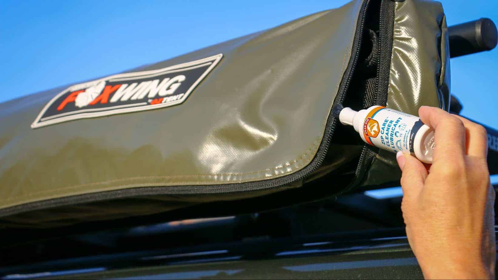

Now that it’s clean, your zipper will need some lubrication and resistance against the elements. There are many opinions on what method works best, but beeswax or a similar product will generally work well. I chose to purchase Zip Care for $7 on Amazon, and thus far I feel its a better solution. Read more on that below. Take whatever solution you choose and apply a thorough coat of it to the open zipper on both sides. Run the slider back and forth several times and then wipe away the excess lubricant. Repeat as necessary until the slider runs cleanly down the teeth.

Whether you’re looking to clean your awning or just need a backup solution on the trail, I’d highly recommend purchasing a bottle of Zip-Care. It was well worth the $7 I spent online, and it doesn’t even require you to clean the zipper with soapy water, making it a perfect choice for “trail-fixes”. To determine just how effective it was, I decided to try it on something other than my brand new Fox-Wing. After some searching I found another awning that had been used for several years without a cleaning. It was near failure point, which made it the perfect candidate for this test. I decided to follow the directions exactly, so no pre-wash was done with soap or water. I used the dry-brush tip to dust a section clean and then applied the solution along both sides of the teeth. After a few passes of the zipper the difference was shocking, so I made a quick video and posted it below. The quality isn’t great, but I felt seeing the results was worth a thousand words.
