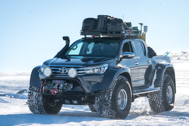

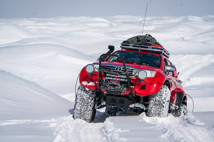

The Vehicle: The list of vehicles truly suitable for polar travel is short, with the clear choice for the last decade being the Arctic Trucks Hilux AT44 conversion. I have trusted these vehicles to get me to the South Pole (twice) and all the way across the Greenland ice sheet. My first trip with these vehicles was in Iceland, crossing several glaciers. Their performance and reliability are made possible due to thoughtful modifications like 44-inch Nokian tires, dual transfer cases, and a Land Cruiser 200 rear axle. With air lockers front and rear, and tire pressures into the low single digits, it is possible to ascend glaciers and travel on extremely soft snow. Recovery equipment includes a ComeUp winch and polar-rated MaxTrax.  Due to the significant flotation, the ground pressure from the vehicle is less than that of a human footprint.  arctictrucks.com
The AT44 Hilux I drove with Emil Grimson across the Greenland ice sheet with the team from E7

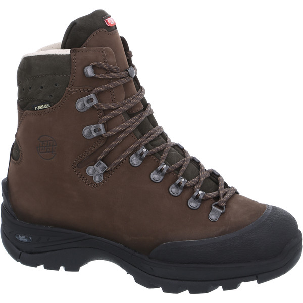

Boots- For almost all of my polar and non-polar winter driving, I use the Hanwag Alaska GTX, which has proven warm to -20°, and tolerable down to -40°. Like the parkas, there is a significant difference between solutions for active scenarios, and just standing around below zero. These Hanwags are my active and driving choice and served me well in the Arctic.

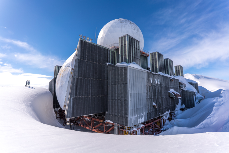

Right out of a science-fiction novel, an abandoned US radar installation located on the Greenland ice sheet.

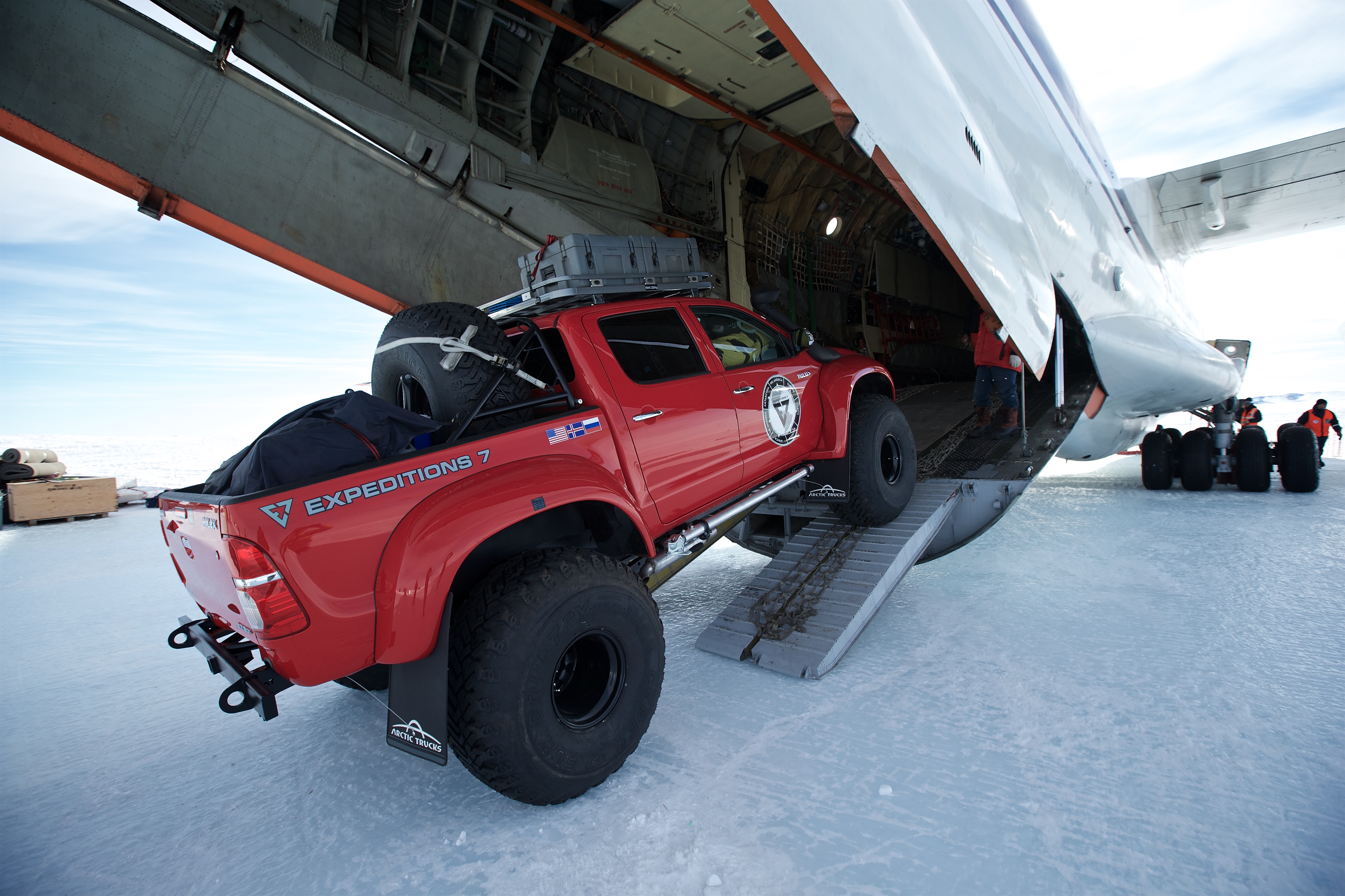

Unloading the Arctic Truck from the Russian IL76 in Antarctica

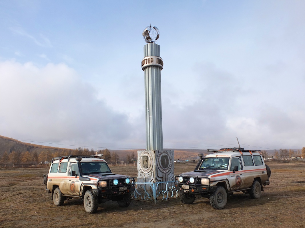

The author at the Pole of Cold in Siberia, the location of the coldest recorded temperature on land in the Northern Hemisphere (-90° F).
