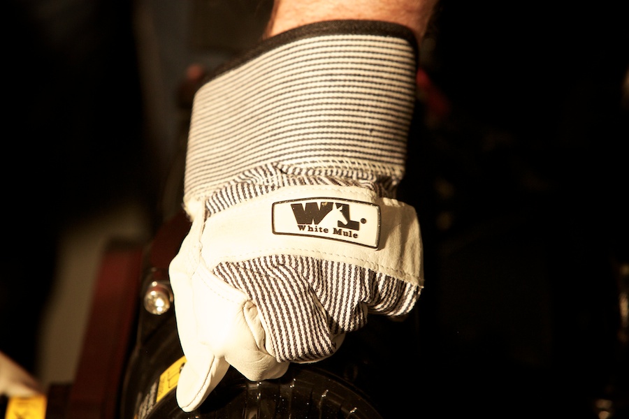

Construction and Fit: Fit with utility gloves is critical. Long gone are the days when using a loose-fitting pair of gloves is recommended, that practice falling out of favor about the same time as using choke-chains around live trees and Holley Carburetors. Some subscribed to the idea that a recovery or winching operation required an oversized and loose fitting glove with an open gauntlet to allow the glove to be easily pulled from the hand in a pinching hazard. Well, there are two significant issues with that theory: 1. A loose fitting glove WILL get caught in nearly everything, and far more frequently than a proper fitting unit. That is the problem with a loose fitting glove; it has extra material and makes it difficult for the operator to manage the size of the glove and pathway of the material. 2. Operation of the equipment should not result in a hazard. Proper technique is to set all rigging and connections without a load, and the operator should not be conducting winching or dynamic recoveries anywhere near a pinch or snag hazard. The same applies to HiLift and Tirford Proper assessment, rigging, inspection, cribbing, etc. will all eliminate the hazards under tension and operation. So the hazards that remain are cutting, impact, abrasion, etc., which all benefit from a proper fitting glove.
Avoid loose fitting gloves like these – the extra material and loss of dexterity just result in the pinching hazard they are attempting to protect against.

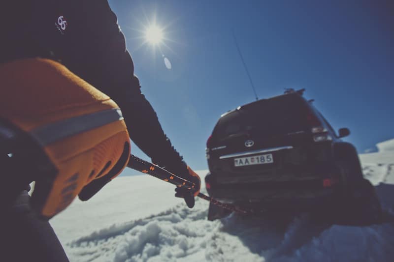

Overland Journal’s 2012 crossing of Langjökull glacier, Iceland. Photographer: Sinuhe Xavier. Image used with permission: Viking Offroad

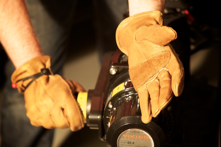

For construction, we have found that a (primarily) leather construction provides the best compromise in protection and dexterity, particularly when combined with additional wear panels and variations in material thickness. Synthetic and rubber gloves continue to improve, but heat is the enemy, as is abrasion. The best combination is a leather palm with synthetic panels for moisture wicking, also incorporating rubber protection elements to reduce injuries on the knuckles and soft tissue at the back of the hand.

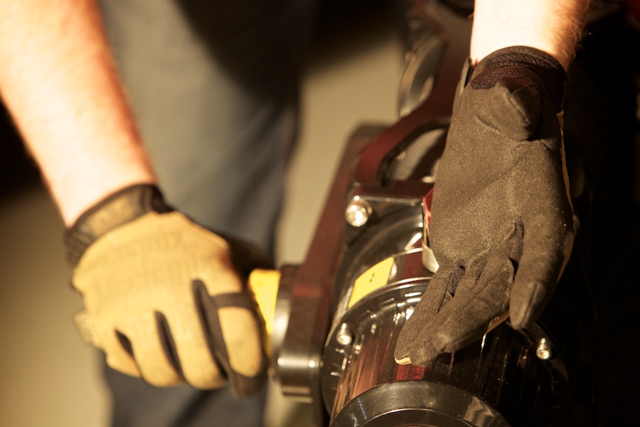

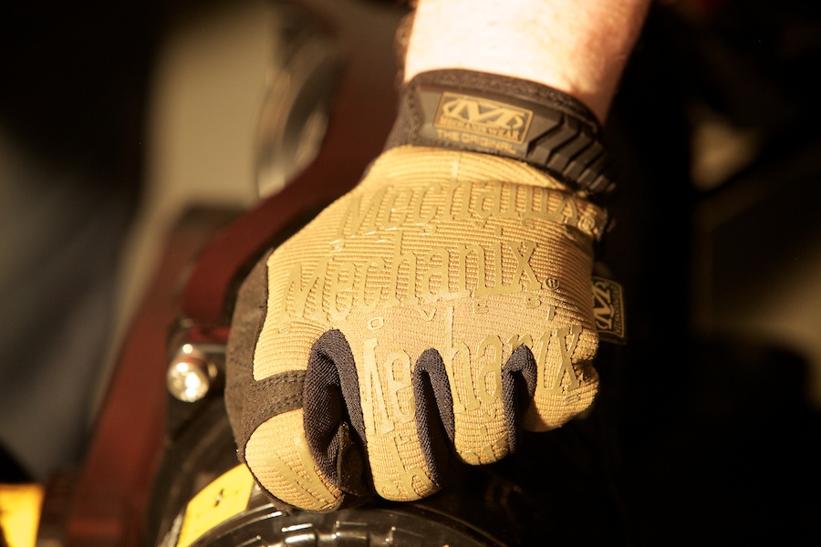

Mechanix Original: $24 (Made in Vietnam)
The Original Mechanix Wear gloves provide minimal protection, but maximum dexterity and sensitivity. In nearly all recovery scenarios, these gloves are barely acceptable, principally if abrasion or cutting hazards exist. The glove is made from simulated leather comprising nylon and polyurethane (Palm) and knitted fabric comprising 99% nylon and 1% spandex (back). These gloves can serve as light work gloves and driving gloves, but little else.
mechanix.com/tactical/the-original-coyote-glove
Pros: Maximum dexterity and sensitivity Excellent repair/driving gloves Good in warm weather
Cons: Thin material Limited protection Not suitable for most recovery operations

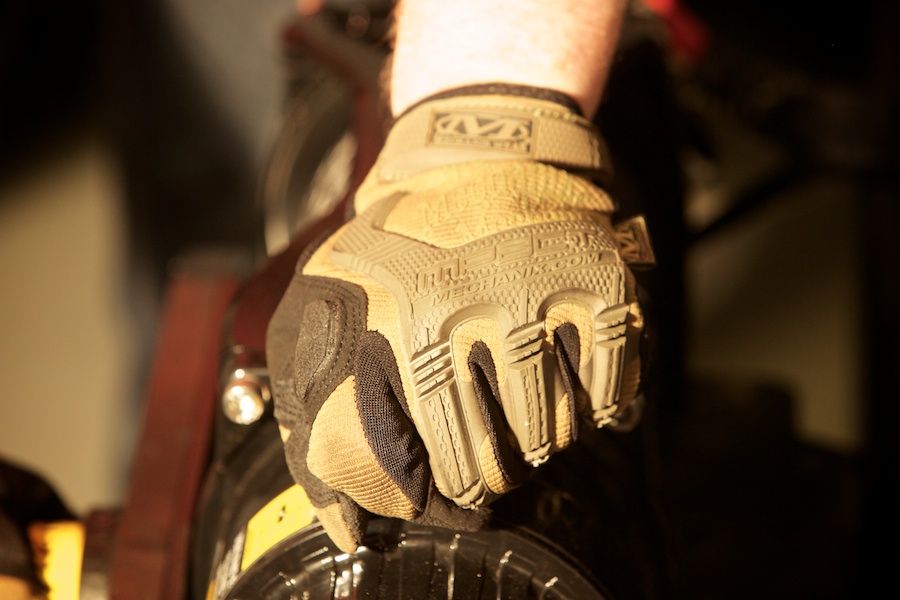

Mechanix M-PACT: $34 (Made in Vietnam)
These gloves are quite popular, particularly with military units, and for good reason: High breathability and effective impact protection. They are adequate for recovery operations and general trail work, but will ultimately lack the durability and heat/fire protection for long-term use on extended trips.
mechanix.com/tactical/m-pact-coyote-glove
Pros: The perfect desert glove Good dexterity and sensitivity Good impact protection
Cons: Finger tips lack durability Light abrasion protection Synthetic material limits heat protection

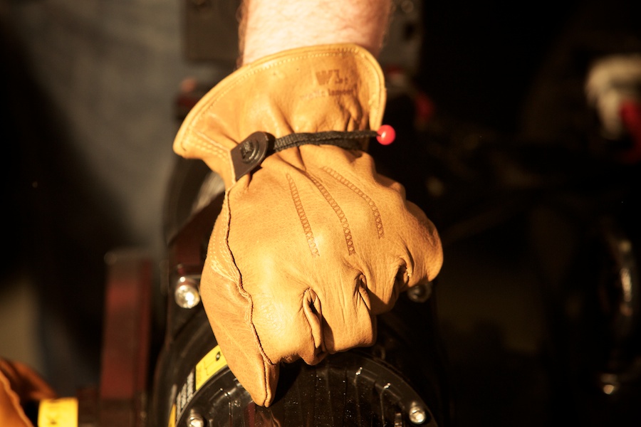

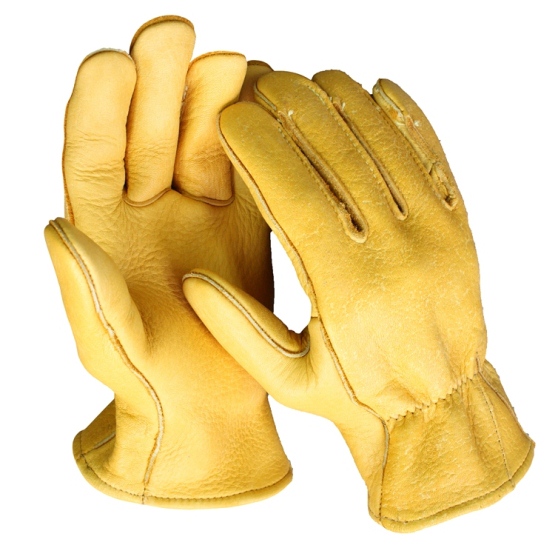

Cowhide Work Glove: Available and made nearly everywhere ($12-$60)
We bought this pair from True Value, a local hardware store, but gloves like this are available just about everywhere. So this is not a review of a particular brand (these are Wells Lamont), but an overview of the important characteristics. For material, cowhide, elkhide and bisonhide all have advantages, but a thicker, stronger hide is a good place to start. Stitching comes next, with an inspection of the seams, particularly at the fingertips. Look for double-stitching where appropriate and an additional wear panel at the palm for abrasion resistance. The cuff should also have a means of closing around the wrist to help prevent dirt/mud/snow from coming into the glove. Don’t underestimate the standard leather work glove as a good, value option.
Pros: Readily available Low cost Good abrasion and heat protection
Cons: Mixed quality, so research a good brand Can be warm in hot climates Moderate dexterity and sensitivity

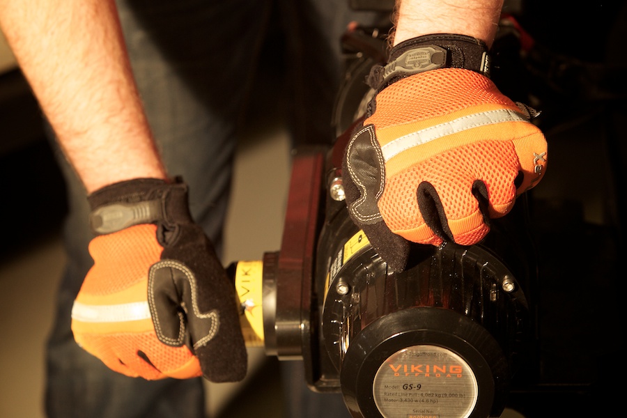

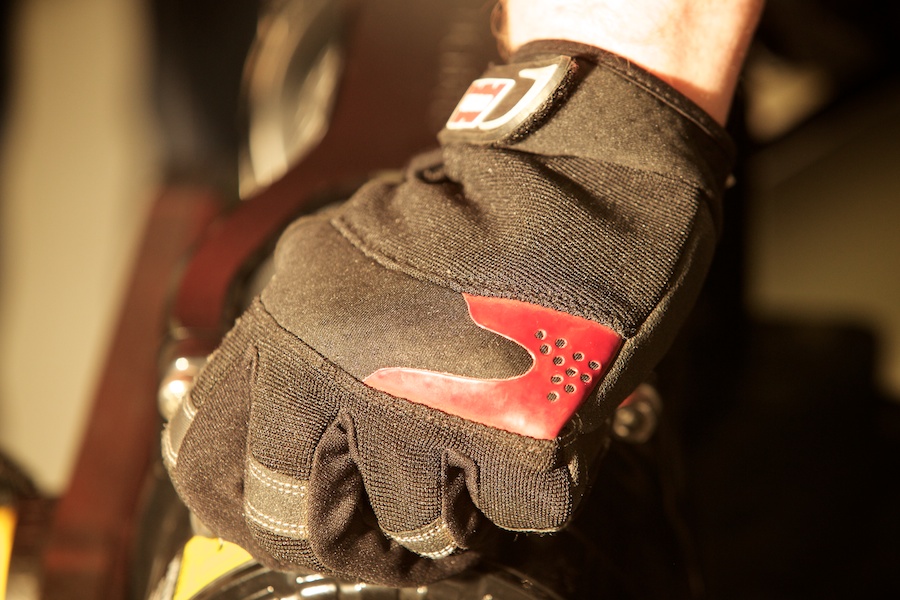

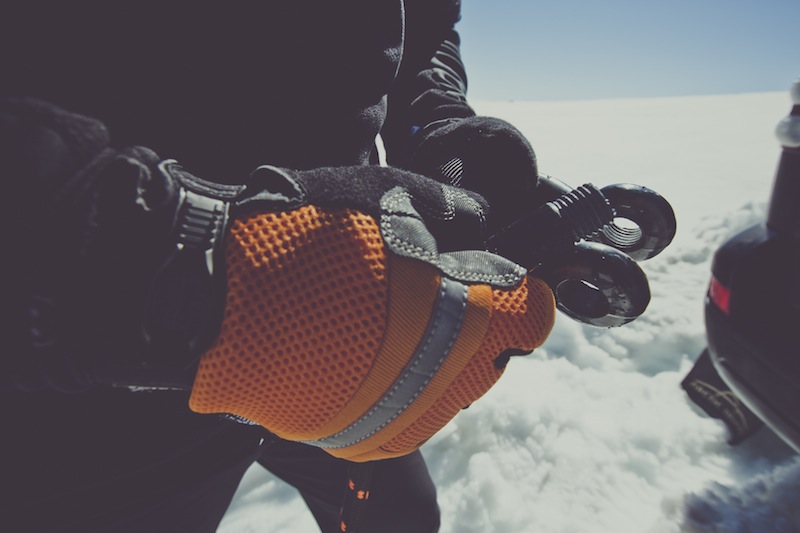

Ergodyne ProFlex Insulated: $25 (Made in Indonesia)
We often travel in cold environments, so a proper recovery glove with insulation needs to be part of the lineup. This Ergodyne glove is the best example we have used, with high visibility, Thinsulate 40-gram insulation, reinforced palms and effective dexterity/sensitivity. These are the gloves we use for all conditions ranging from 0-60F and sometimes below zero. We crossed the largest glacier in all of Europe using Land Cruisers on 44” tires and these were the gloves of choice. They are effective for driving and all recovery operations. They are high visibility with a bright orange back panel and reflective tape. They have limited heat protection, given the all-synthetic construction. At $25, they are a bargain.
vikingoffroad.com/ergodyne-hi-vis-proflex-gloves-l-872
Pros: Perfect cold weather recovery glove Great value High visibility Good protection
Cons: Limited heat protection (fire, etc) Limited impact protection

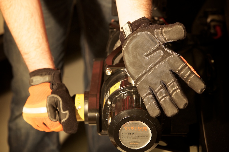

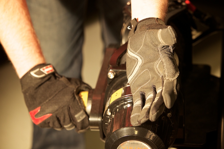

Warn Recovery Gloves: $25 (Made in Pakistan)
Warn knows recovery, and their newest gloves reflects their experience. This form fitting glove has a breathable back panel and a terry cloth thumb panel. On the palm, the glove is all business with generous protection and a Kevlar reinforced wear panel. Padding is provided at impact points, while articulation channels allow for good dexterity and range of motion. These gloves are comfortable to wear, although I found the fingers to be a bit longer than others. Heat/fire protection is limited with the all-synthetic construction and the all-black color makes visibility a challenge with marshaling/spotting operations.
warn.com/truck/accessories/winching_gloves.shtml
Pros: Good protection Quality materials Comfortable fit
Cons: Low visibility (all black) Long fingers Limited heat/fire protection

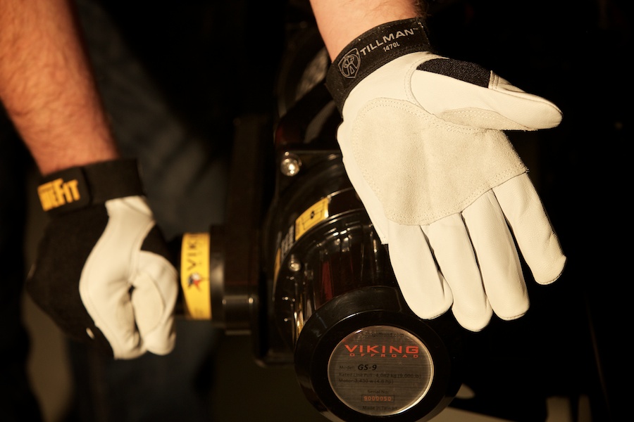

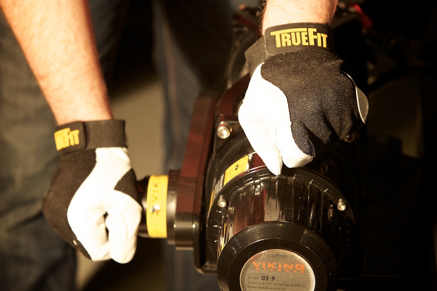

Tillman TrueFit: $15 (Made in China)
The TrueFit is an ideal warm/moderate weather recovery glove, ticking all the important boxes for fit, materials, quality and visibility. Made from top grain goat skin, the palm also includes a suede panel for improved abrasion resistance and grip. The fit is snug, providing good dexterity and sensitivity, but the leather material still offers adequate protection. The back panel is black spandex, but lined with cotton for comfort. With the white leather, visibility of the palm is excellent, but the black rear panel only shows visibility from the leather at the fingertips. This is a lightweight recovery glove that performs well in warm climates while still offering excellent abrasion, cutting and heat protection. Impact protection is limited, but at only $15, this glove is the runaway value champion!
vikingoffroad.com/tillman-truefit-gloves-xl
Pros: Quality materials Comfortable fit Good dexterity Good visibility on palm
Cons: Black rear panel limits visibility Limited impact protection
